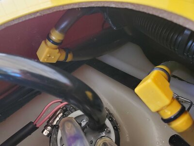

Lastly, I have the seat off to access the fuel pickups and troubleshoot. When riding, especially at higher RPMs, there are tiny streams of water pissing out of these two elbow fittings above the tank. It looks like there are intentional pinholes in them. I can't imagine this has anything to do with my root problem, but I'm curious if this is normal?

It sounds more like something electrical is getting wet than actual water ingestion.
What makes you think your plugs have water on them? Do you actually see a drop of water bridging the gap?
Yes, those elbows are supposed to have the hole. Jet s of water should never be spraying out of them, if there is then the white straws inside the jet pump nozzle are missing and water is being forced into the hull instead of pulling it out. This will cause the hull to flood with water.

Correct, one of the plugs had a drop of water in between the gap. And also, a little water in the airbox. It was never enough for me to think it could cause an issue, but now I'm not sure.
My CDI box is properly sealed and I just verified it's completely dry inside.
Got it - I figured that couldn't have been normal and is at least part of the reason it takes on water. I didn't think this ski had a siphon bilge since it has the electric one, but sounds like those elbows are part of the siphon system? Are the straws I'm missing in the parts diagram below?
Thanks for the help, guys. I cannot verify for certain since this ski is at my parents' place right now, but I believe I am missing those.
Anyone have a part #? I do not see them in the diagram above.

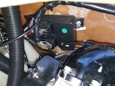

Is your MPEM in the nose of the ski or up high on the side wall?
Seadoo found that the ones in the nose were getting wet and corroding the connectors so they blocked off the nose air inlets and moved the MPEM's high up on the side wall but I don't remember what year the change was.
If it cuts out when the nose gets under this could be it.

Interesting thought. I'll need to verify when I'm at the ski again. I know my CDI box is in the starboard-side of the bow, pretty low down, but I don't believe the MPEM is in this housing.
I also remember reading about SeaDoo plugging those two inlets at the bow. I believe they did that starting in year 2000. On my ski, they're open and connect to two tubes that go down into the hull. I recall reading about a modification to block these off on the 98/99's with no penalty to intake breathability.
I also still need to determine which siphon tubes my pump is missing. Unsure if I need the long or short ones. Somewhere else on the forum, a member confirmed their '99 GTX uses the long ones, so that may be where I start
Got to my ski last night and confirmed I am indeed missing the white siphon tubes. No surprise since the guy who "rebuilt" this ski and my SPX's pumps is a joke and there are numerous parts he left out. Add one more to the list.
I also confirmed the location of my MPEM which thankfully is not in the problematic bow area, but high up on the wall on the port side. That said, this is in the area of where the two siphon tube elbows are incorrectly pissing. It seems entirely plausible this spray could interfere with the electronics in this area of the ski.
Can anyone help with a part number on these siphon tubes? BRP doesn't list them in their catalog!

UPDATE: Apparently BRP forgot to list this part for the XP in their 1999 catalog, but starting in 2000, it's included.
Part number is 271001133 which looks like the easier of the two versions to source.
What is the recommended way to adhere these into the pump? Marine epoxy? Silicone? I imagine they have to be quite secure since they're constantly getting jet blasted.

I have never has them out but I would use a little epoxy.
Also make sure you clean all the mpem connections and use a little DI-electric grease.
I had one missing on my 98, I test fit it in and with some light tapping it went in and wasn't coming out...easily. So thats how I left it, been over 15 hrs on it and still there.
