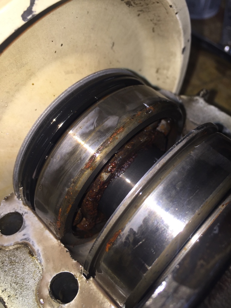

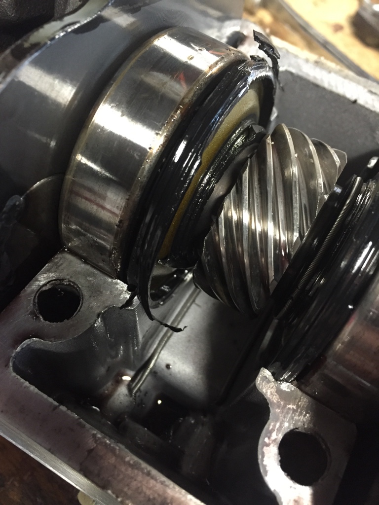

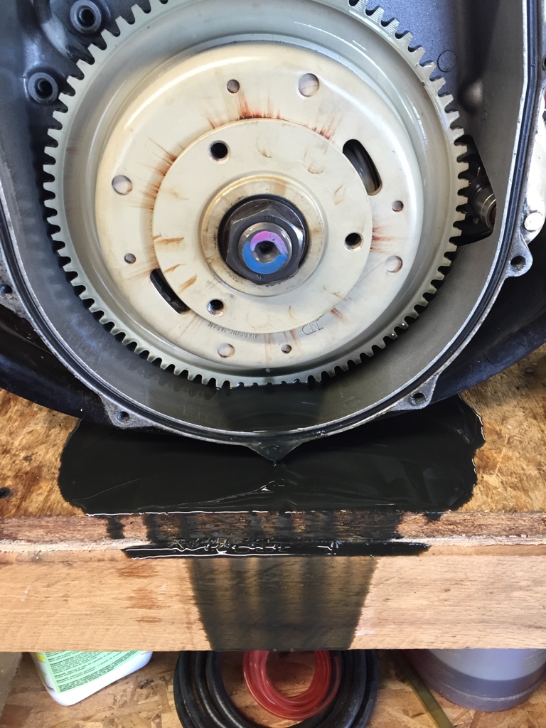

Well then... Pulled the flywheel cover and there's that.
looks like the crank seal behind the flywheel is leaking like a siv. pull that flywheel off and inspect the damage. you can do that crank seal very easily I believe
Yeah. What concerns me is wouldn't the inner crank seals and the rotary valve seal both also have to be bad for oil to get to the outer crank seals?
Why is the oil so black? Or is it just the pictures
I think it's because it's a mix of oils. The oil he had in it was green. The oil I put in was purple, quicksilver synthetic pwc oil. The quicksilver oil is very dark purple.

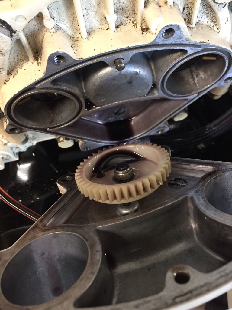

OK, so either do a pressure test or just bite the bullet and buy/build an engine. Did you remove the formed o-ring gasket from the oil pump cover? you're literally a few screws away from removing the rotary valve cover. You could mock up your oil reservoir and fill it and see if the oil seeps from the RV shaft seal or actually fills the crankcase by looking in the bottom end. It's sorta the lazy mans approach to a pressure test, you just have to waste more oil. If your crank seals are smoked you're into an entire rebuild or buy a reman engine.

I do have the rotary cover off currently. I just don't know how to pressure test
Block the out side of the RV nipple (the one on the starter side), the pump about 4 to 5 psi into the front RV nipple (carb side). Use a shut off ball valve between your supply and the nipple. Close the ball valve and see if the pressure holds. probably not. There is where you would have the entire engine assembled and you would block off the carbs where they mount to the manifold, block off the pulse nipple for the carbs, block off the top of the exhaust mani. Then if the air leaked into the engine you could then unthread one of the spark plugs and see which one hisses air. That tells you which seal on the inner part of the cranks is weezed. But we already know the mag side is weezed as well as the front outer crank seal. Gotta keep the girl happy, looks like you're parting with cash. You could also scour ebay for a new reman OEM crank for a 720, they do come up every now and then. You can score OEM first over pistons for 720's on ebay too, brand new. I find 787 pistons for my builds on ebay almost ant buy one get one free pricing which is close to aftermarket pricing. Then have your cylinders bored, new crank and you're in for the price of a reman but with all OEM parts. Even OEM gasket sets are on ebay cheap. You just have to watch for them and know what a good price is.

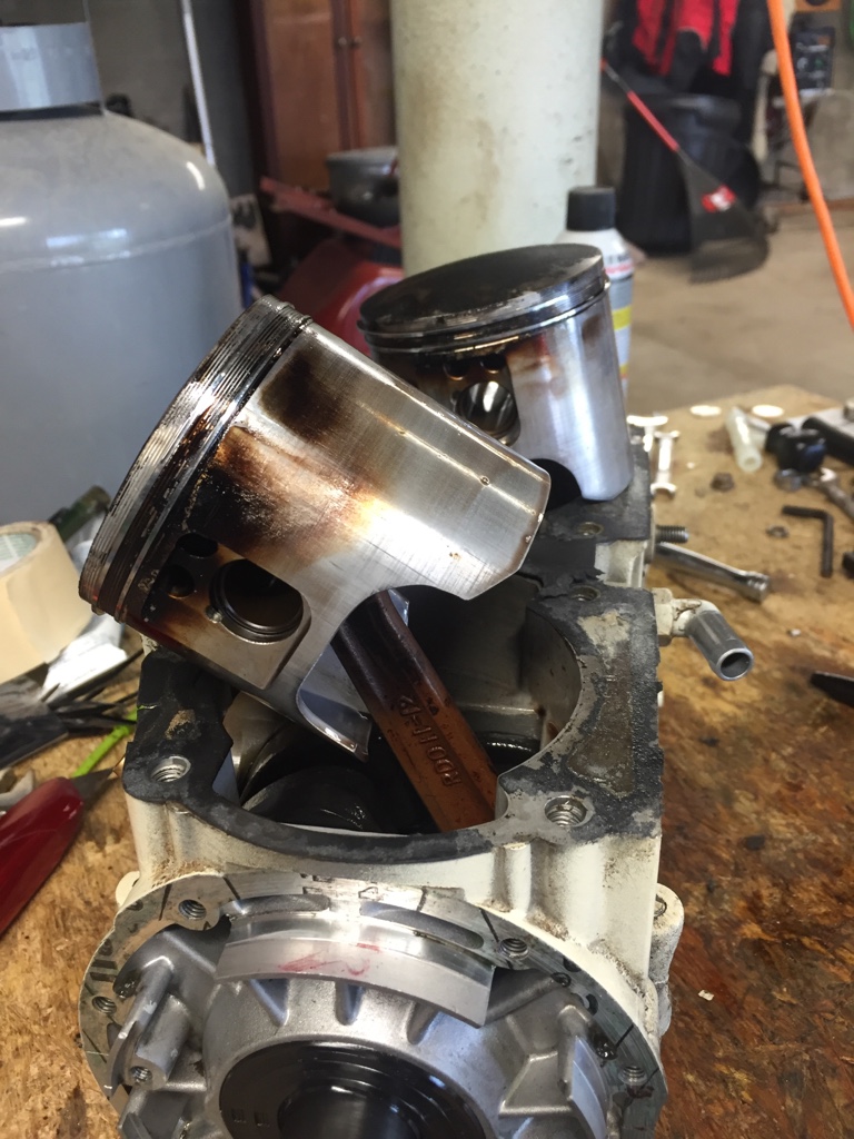

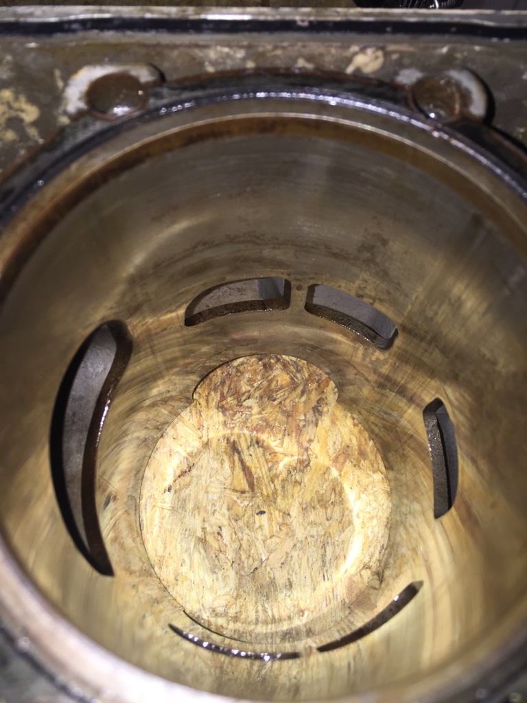

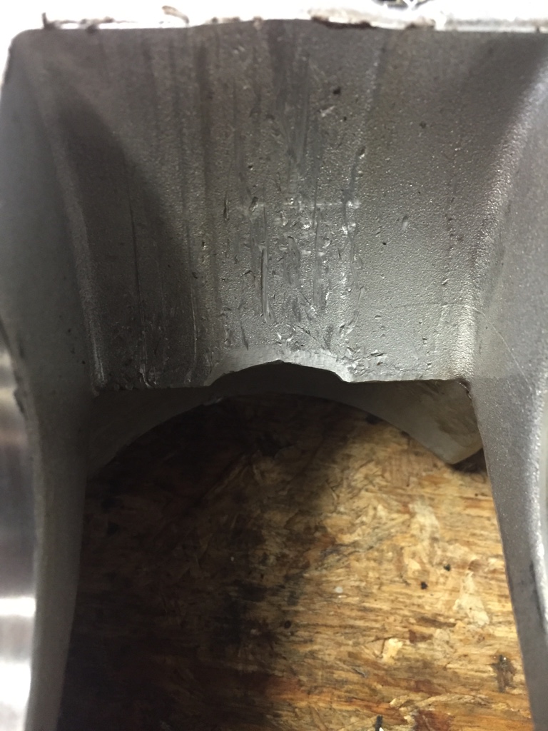

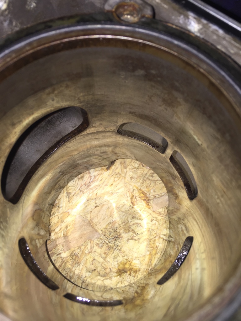

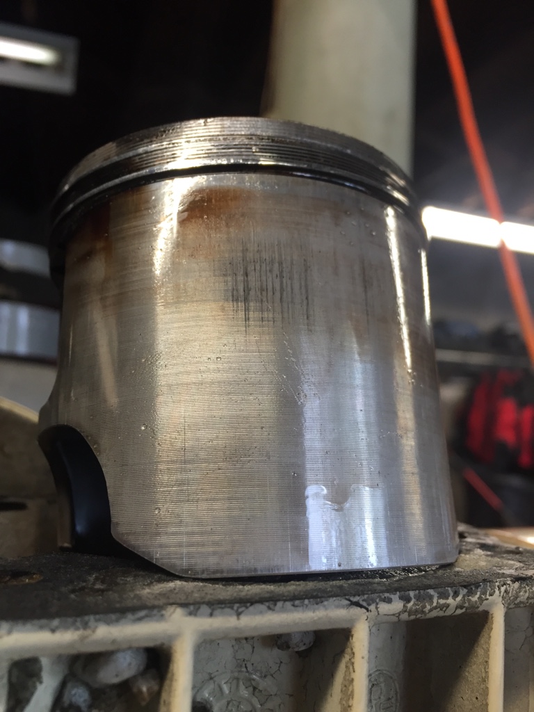

Well, that engine has already been rebuilt once in it's life time. In the first pic you can see the crank pins are welded. In the piston pic the original pistons do not have extra holes by the wrist pins. And those are not OEM rods. I'll go out on a limb and say the thing drank all the oil on this guy and he fried the inner crank seal. Not a biggie by any means but I would just do it all.
Look towards teh front left of the pic and you can see the welded pin if you look close enough

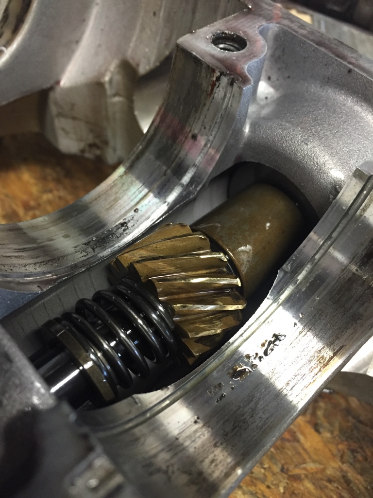

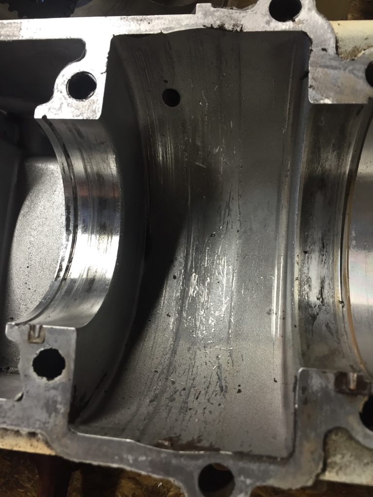

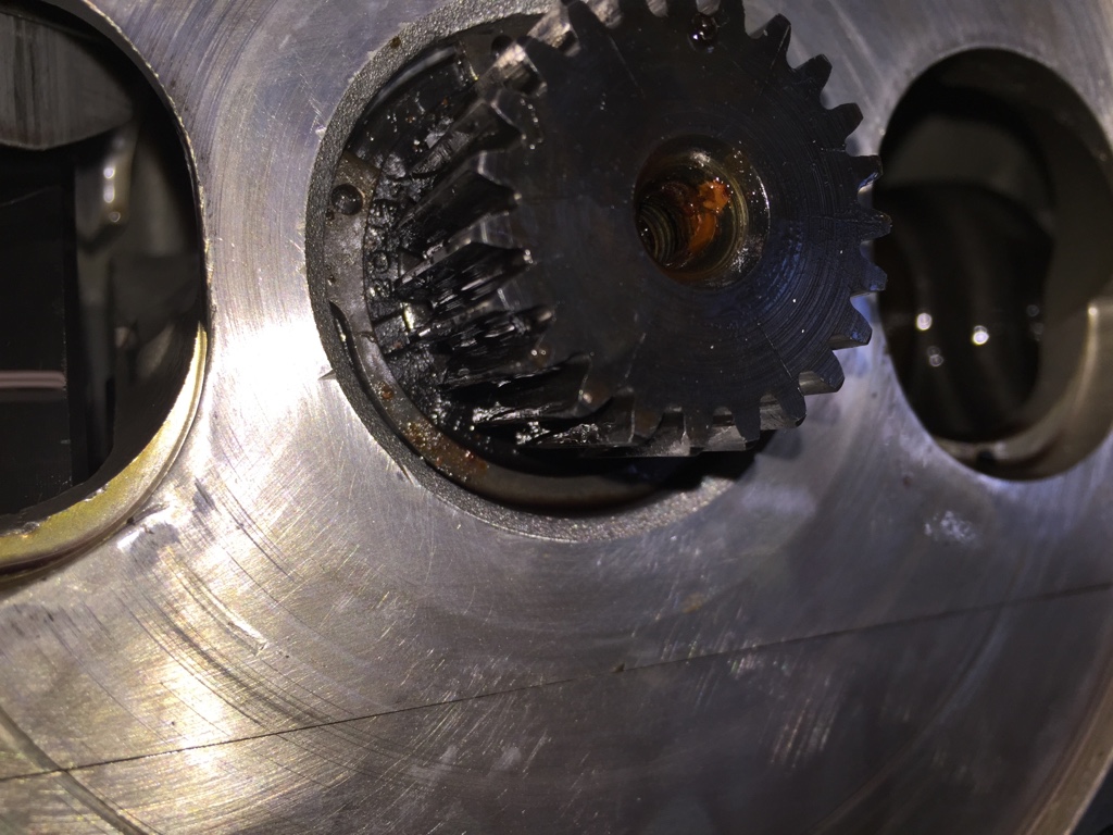

Yeah, it looks like this case had a worse failure in its history. Is this case still ok? I need to figure out now if I should have this crank rebuilt and just drop the rebuilt crank in and do a new top end, buy a reman crank (and what reman company) and do a top end, or just put it back together and send it out as a core on a rebuilt engine (and what company to use to buy a reman engine). I just kinda feel that by the time I buy a top end kit ($166 for WSM on eBay), spend $275 on a crank rebuild, buy a new gasket set, and probably do a rotary valve too since that brass gear has some chips out of it and some bent over edges (if you can tell in the pic)... That's $600 + in parts to rebuild and no warranty to fall back on when it decides to self destruct. Which would be my luck.
