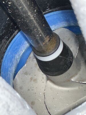

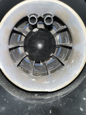

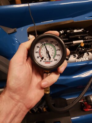

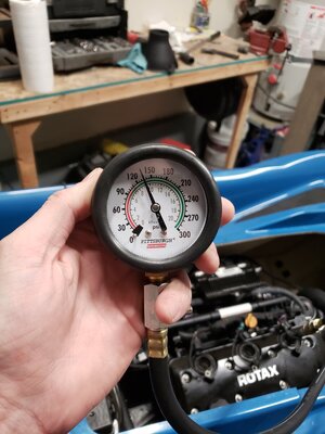

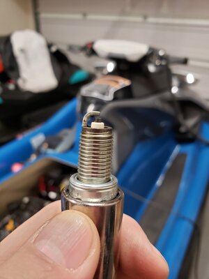

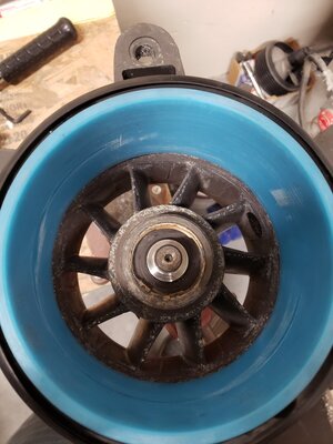

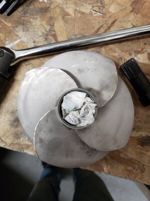

- Plugs pulled and changed, but were perfect. Compression tested, and were 168 PSI on the button for each cylinder with my gauge. Impeller has extremely minor imperfections, but nothing that could cause a 13 MPH reduction is the typical 55 MPH top end reported for smooth water.
