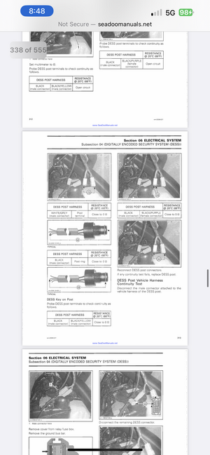

Having a no start issue with my 2008 rxt-x 255. I put the key on the post and have nothing. I believe I have narrowed it down to a ground issue with the main relay in the small box with the 2 30amp fuses. When I check pin 85 in the fuse box I do not have continuity to ground. It I put a jumper to to pin 85 in fuse box my issues is corrected. I have a shop manual and referred to the section on testing the main relay ground circuit but it does not get into detail as to where the ground is supplied from. Should pin 85 be grounded at all times ? Thanks for any help.
