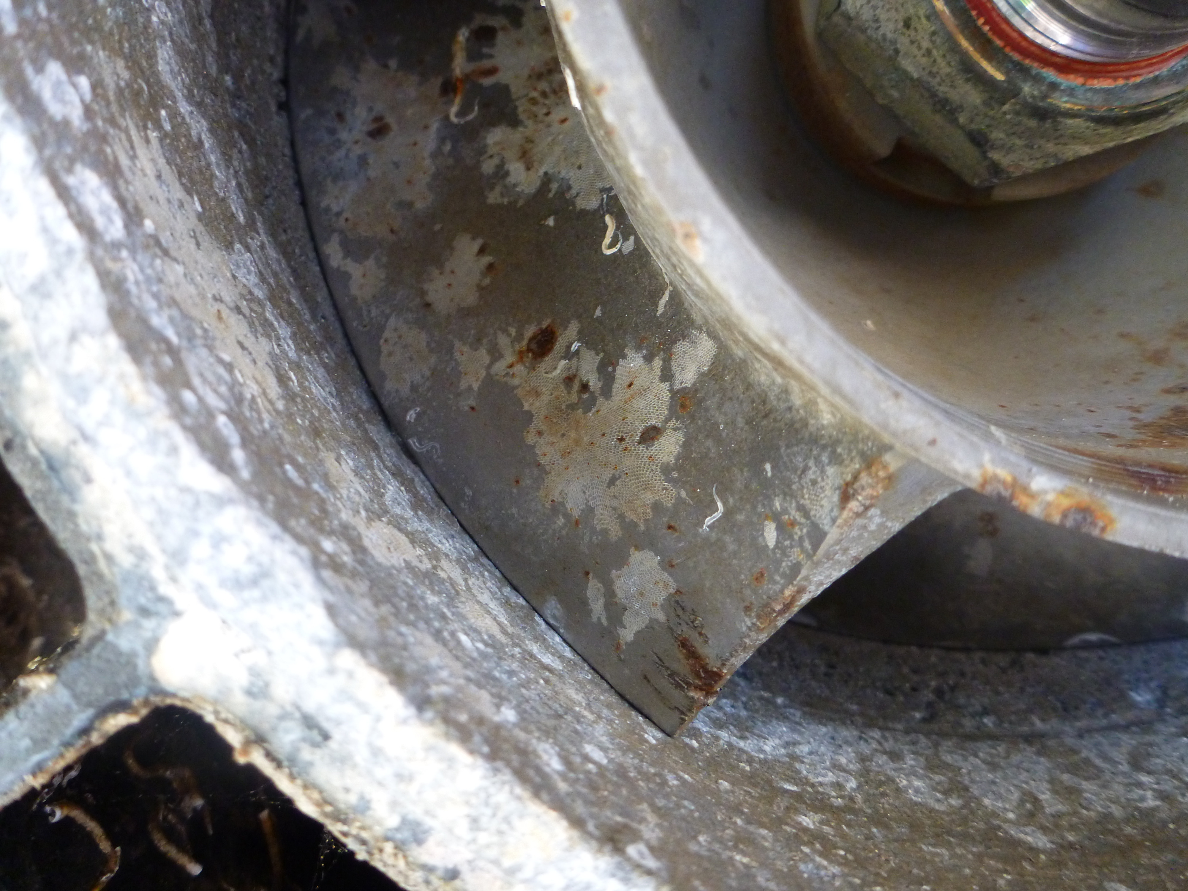

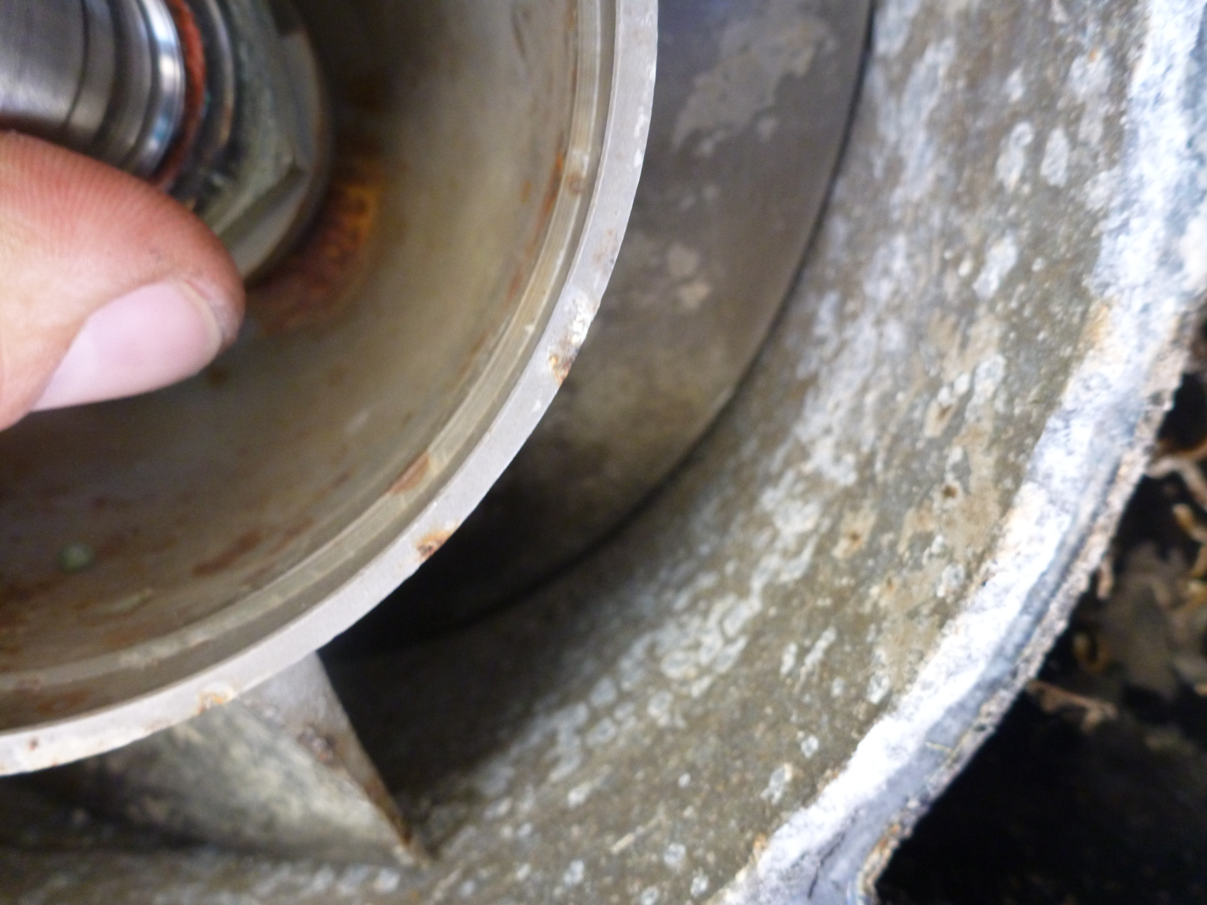

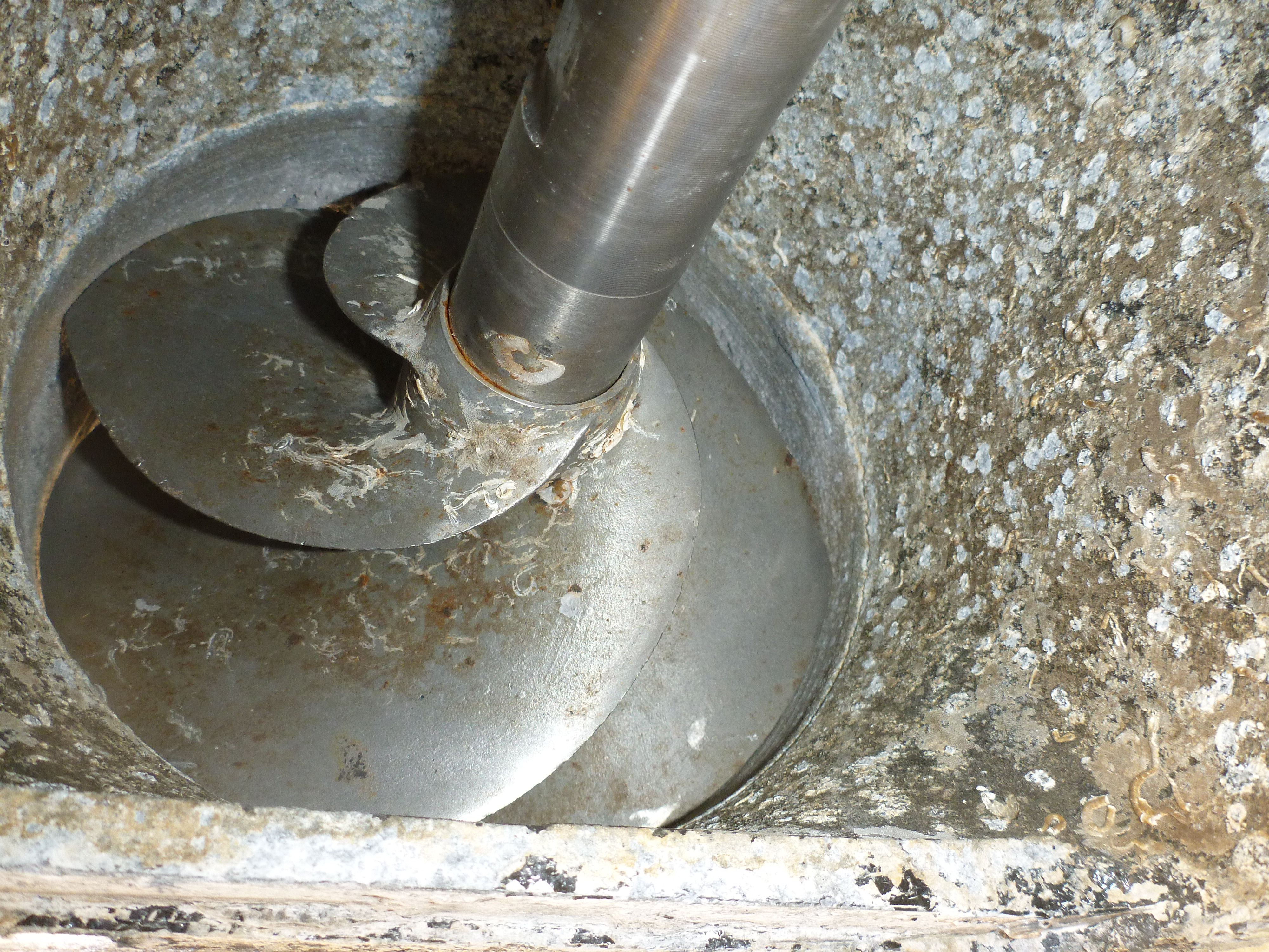

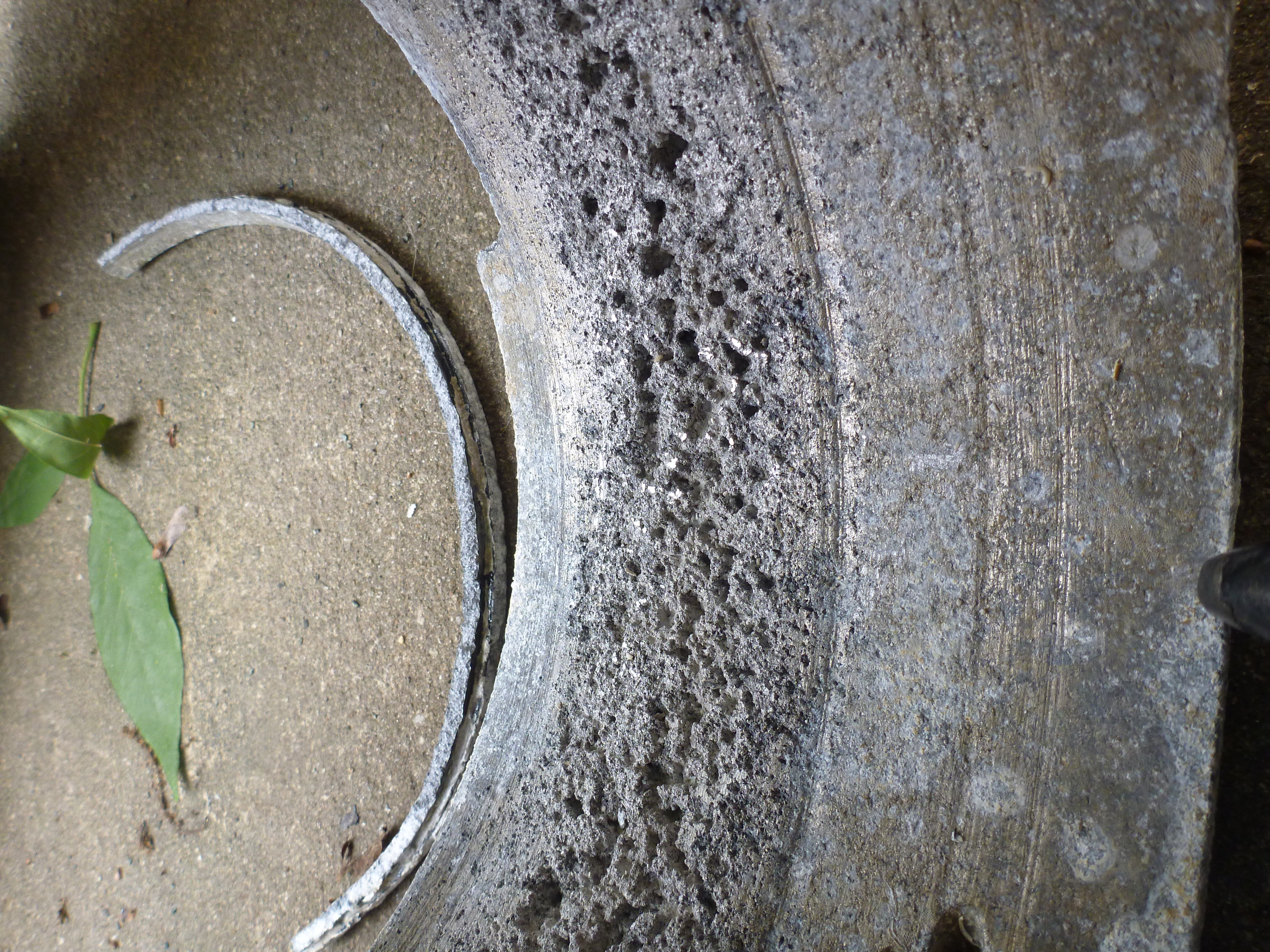

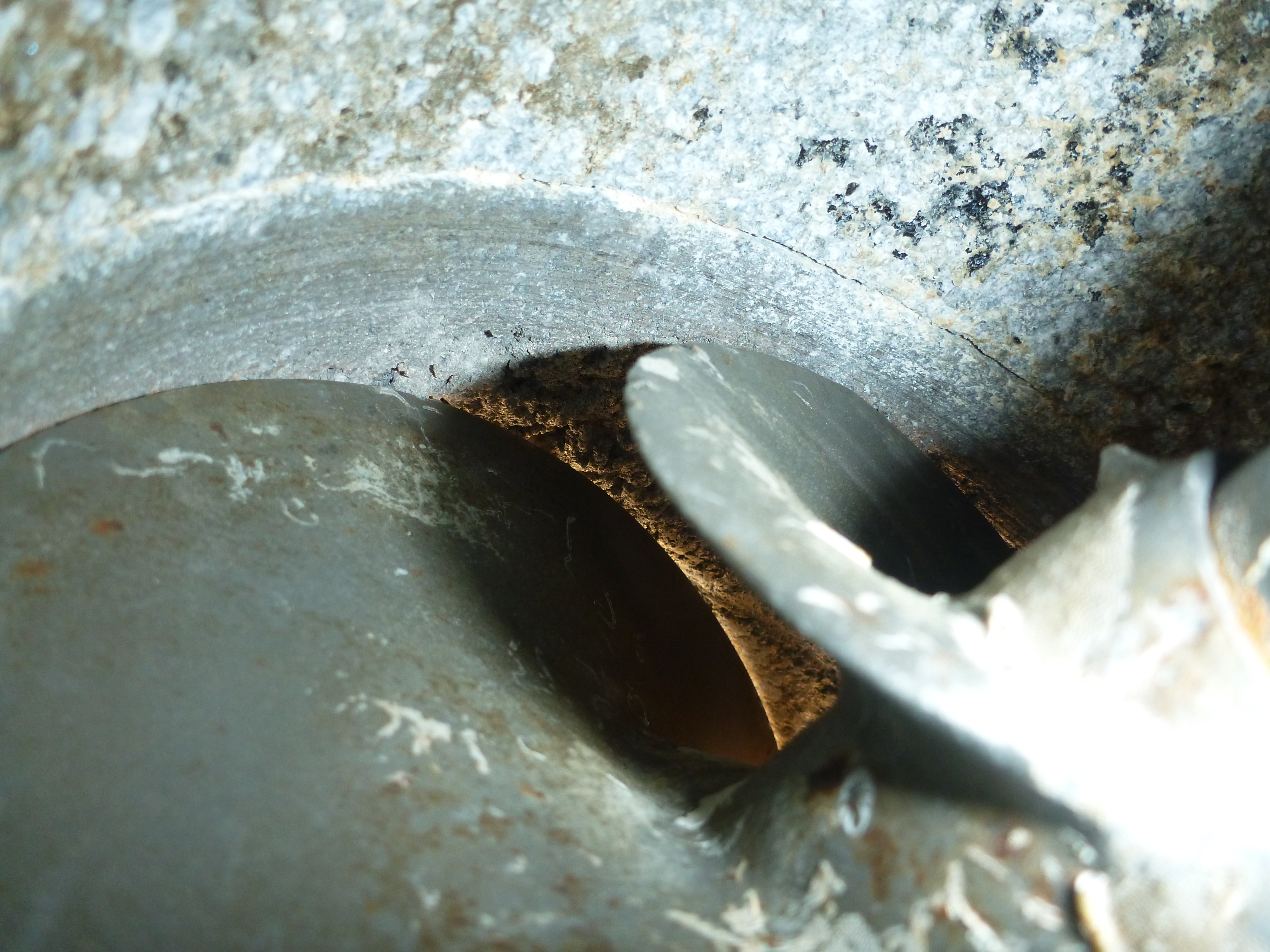

I finally started taking apart my jet pump. The wear ring is shot and the impeller shows signs of abuse as well. I need to replace the impeller, a wear ring, and a couple of broken bolts (stator bolt being one of them sigh).
I have a couple of questions based on my pictures below:
1. Is there any way for me to determine if the impeller is OK with this corroded wear ring to measure against? I was planning to use a solas impeller if a replacement is needed.
2. Are there any options to buying a mercury wear ring? I see that only OEM parts are available since it is a complete assembly in which the wear ring part is not removable.
3. What's the trick to removing the wear ring? Mine is stuck on pretty good and hammering does not seem to separate it.
4. My intake grate has a hinge which allows it to be opened for cleaning purposes (I assume). Are there any advantages to replacing the grate and what type of grate would be better.
5. Which parts which may not necessarily show wear or damage should I replace which I have this apart?
This is what the wear ring looks like
Thanks
