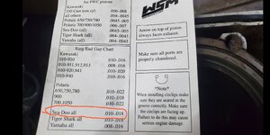

Well pulled it apart and checked the ring gap. .026 on both rings. Looks way big according to the piston specs that came with them. Bad bore job?

I'd say you got a bum compression tester. When I install WSM pistons and rings new, with fresh bores the ring gap is at the top of spec and sometimes over. I've seen (.021") and had no compression issues. I never see less than (.018") on the end gap. I have not had a problem and I doubt that a few thousandths is gonna drop your compression 30psi.
I've had scoured cylinder walls and broken/missing ring parts and still get 130psi, which is why when I see 130psi on a compression test I know the engine has wear. I'm old school 2-stroke. Keep the top end happy and the rest of the engine will remain happy. The metal from worn parts is gonna get into the crank bearings at some point.
You may have a bore size that is at the top of the limit but as long as it is in spec it will work fine. Good Luck !!
Doubt it. 2 compression tester and a bad ring gap .026 No way 2 can be low and they've never shown low on other stuff I've tested.

I sent the seller the pics and ring gap readings. There returning the cylinders and pistons. Any recommendations to source cylinders and pistons? Are new SBT cylinders any good?

I find it strange they vendor is taking back the cylinders based on ring "end gap." When I bore cylinders I don't like going (.25mm) over. Not enough metal to remove if the bore is scoured or even out of round. I go (.50mm).
