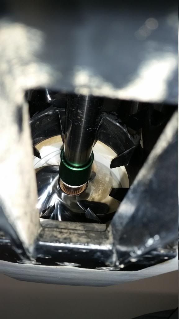

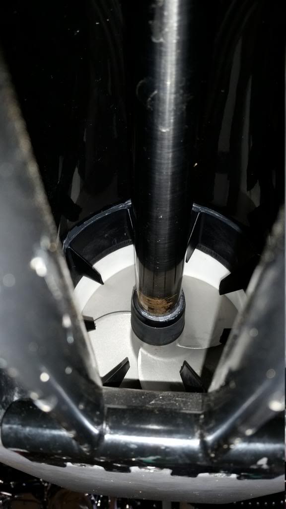

So a little background info. My ski is like a RIVA Stage 1.5. It hit 100 hours this past fall and I had the supercharger serviced and then I parked it for winter. Before parked it was hitting a little north of 8100rpm and 73-73.5 GPS. Now after I got it out for summer. Replaced the plugs and checked the oil level I'm sitting around 7300-7550 RPM and some lame ass like 66mph. I checked the wear ring and it looks fine. The oil isn't overfilled. It hasn't had that ECU update with the piggyback harness or whatever. The shop that did the service doesn't have a BUDS system or any of the such. However. I got to looking at my 08 RXT-X impeller and then my RXP's. My RXT-X has the stock impeller. The RXP has a Solas. I'm going to first show a pic of the RXT and then the RXP's. It looks like there is something not tight on the RXPs to me or maybe this is just how the solas props are? Take a look and tell me what you think.
RXT
RXP
So what do I do about this seal freeloading around on my shaft? Can I remove the grate and put some loctite on that sucker and rescrew it in to the impeller?
