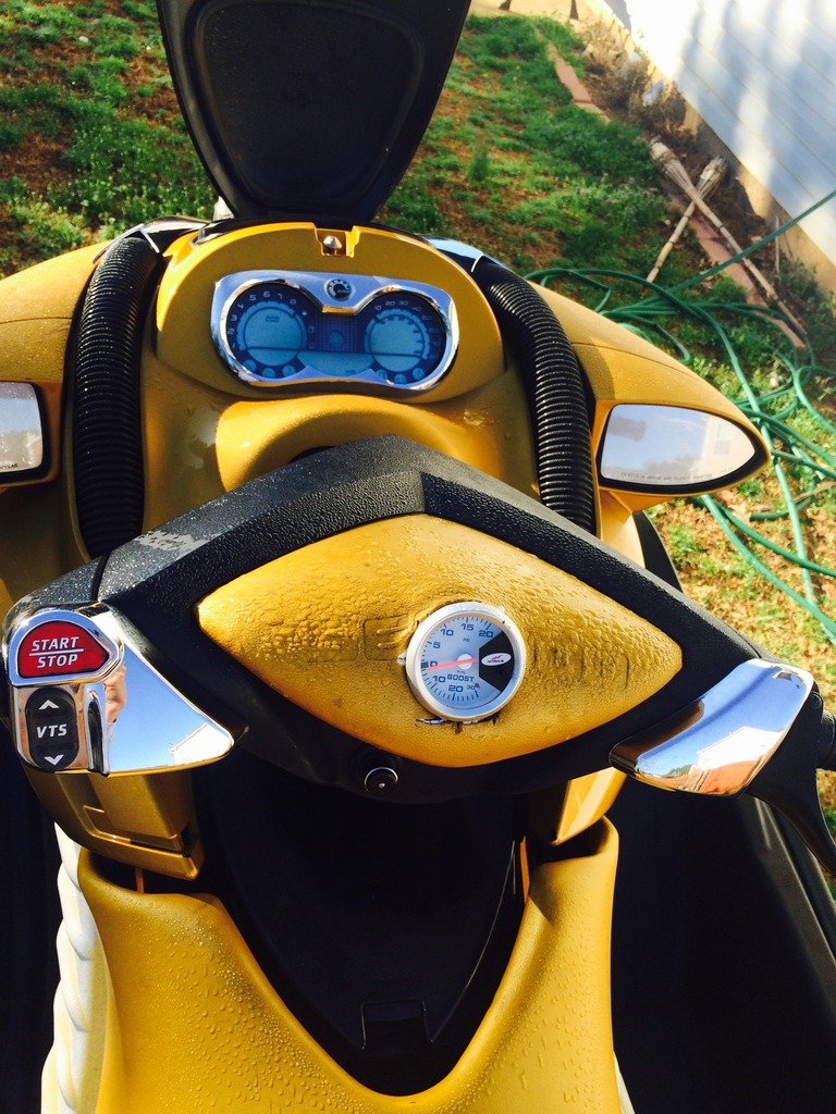

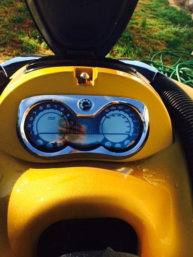

I have a 2004 rxp that doesn't have the mode button, set button and has the newer all digital dash with seems weird due to all the other ones I have seen having all of those and the older style neddle gauges. Trying to figure out why the exclamation sign is on.
I can't make out my schematics from my phone. Looks to be an OEM handle bar...dunno why you don't have a set button. Maybe others will chime in. Nice job on the boost gauge...whoever did it. Does it work?
Schematic for an '04 shows mode/set button on the harness....makes you wonder if that ain't an '03 or earlier ski's handle bars.
Uhm...another possibility...that gauge and handle bar might be from an '07 155 rxp....maybe. You "see" that vts move?
Okay...home computer allows for a better view heh...yeah...that install is a bit rough. You can get a new pad for lil. Thing now with a boost gauge...rrfr. Right now w/o an exic...you're prolly on the rich side...better than lean...but still.

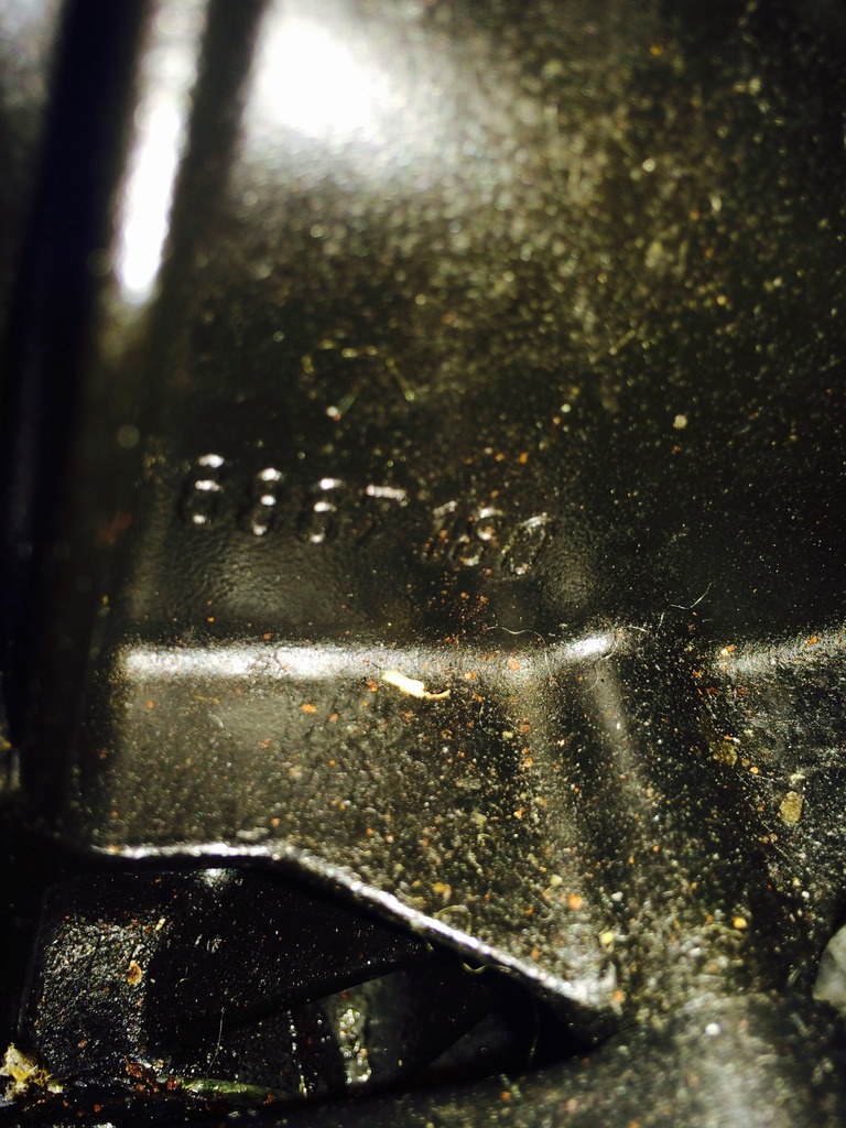

I suspect somebody has transplanted an 08 or newer engine and all electronics into your 04 hull. That gauge won't work without all the electronics included and is an integral part to the ECU unlike the 04 type. I'm guessing they told you it was 255hp engine so probably 08 or newer rxpx setup. These models don't have the mode and set button. I'm also guessing it is modded by the boost gauge but when the installs aren't top notch it worries me that the whole setup may not be done properly. Please supply pics of the motor and we'll tell you exactly what you have. The manufacture date of the motor will be on the front motor plate, hard to see but you can take a pic with your phone and read it.

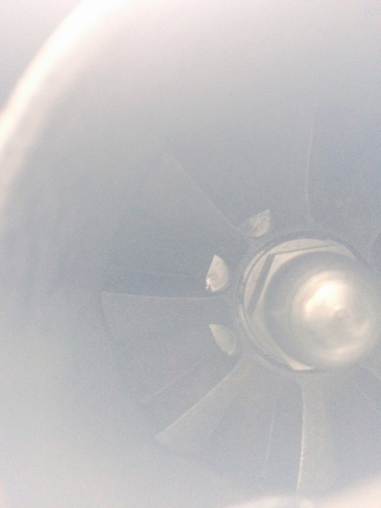

. I will try to get atleast an intake and about the sc wheel, I will take a good picture when I do the tune up this weekend.Now...don't misunderstand me here....it's not that your oem intake and ic "need" to be changed....it just that to get everything out of that wheel that it's capable of...you'll want the better intake...and exic. These chargers boost is volume....restrict that volume and you restrict the hp. can you take a pic of the wheel's blades while you're taking pics of the eng plate?

That looks like an xwheel.
