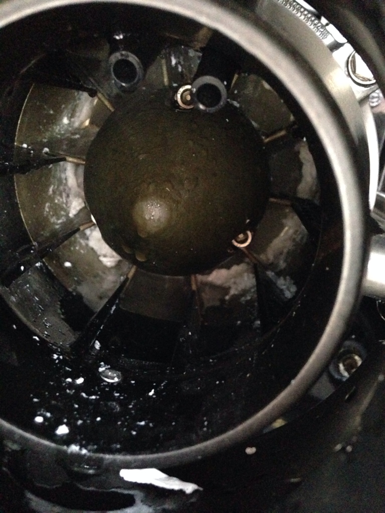

Many have wiped out the drive shat spline, especially on the early 2000 era skis. You pretty much have to open the pump up anyways. So tear into it. Pull the shafts, look at the splines... Under a load it is very likely that the impeller does not move based on the weight and load of the ski...
