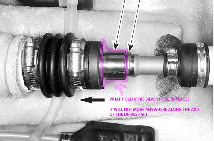

Check the carbon seal (CS). Do you get water into the hull or can you see water running in at the CS?
I don't think I do, if any it is really minimal. If I open the drains in the back, I get a very little out of them. Where is the carbon seal? Is that on the exhaust?
The collar is in purple and the seal is to the left. It is suppose to dribble a small amount of water as that is how it cools itself, (which is why you should never run for more than a minute when out of the water using a hose or not).

The Carbon seal is on the drive shaft where it goes through the hull towards the impeller/pump.
Edit: OOPS, posted same time Coastie did, His pic is a much better reply.
Thanks guys. I see the carbon ring now. The bellow looks good and I don't see any rips. What should I look for? Not sure how long these last. I don't think it had ever been replaced.

As for the carbon seal. its not the bellows you need to look at. It is the black carbon seal just behind the silver collar. check it out when in the water for leakage of water into the hull. This seal can also allow air from the hull to go into the water intake for the pump and cause cavitation.

It is a sc model. I did do a visual but it looks good from what I can tell. Is the carbon seal like a friction plate on an automobile? This is my first ski and trying to figure all the parts out.
