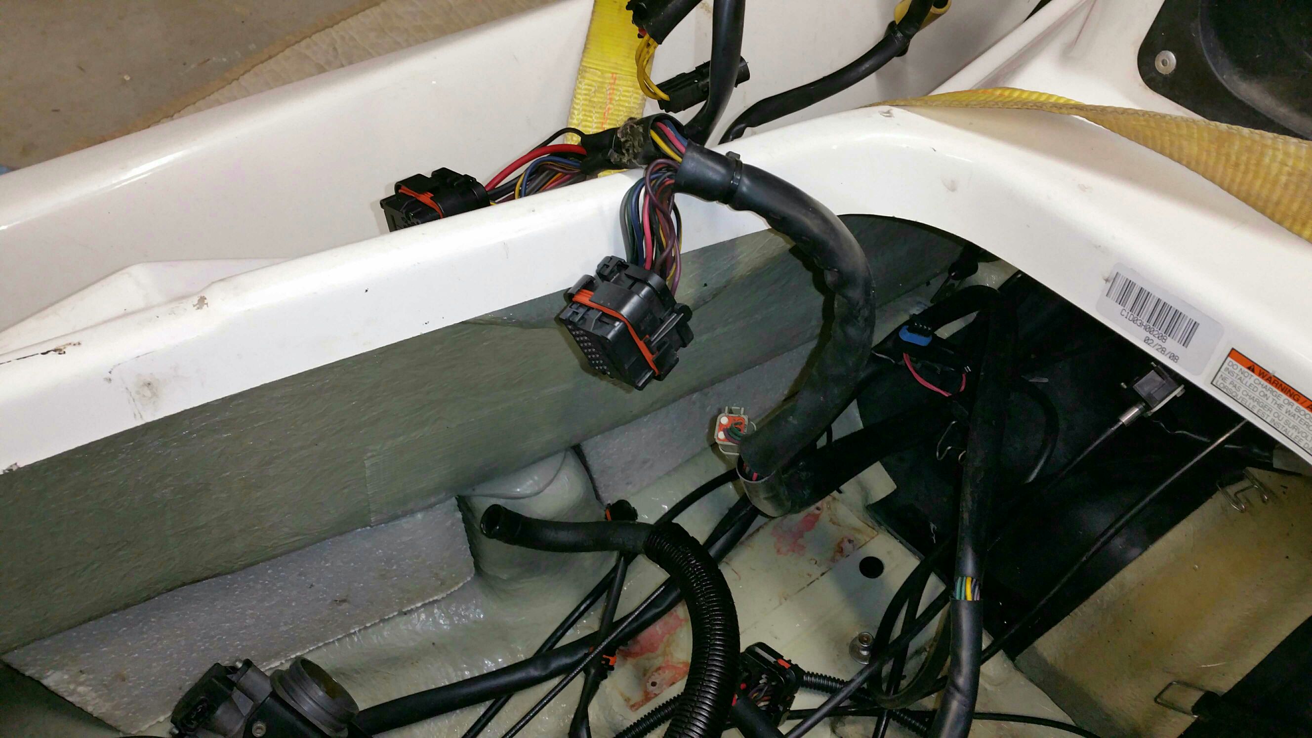

Follow the bottom wire on the right in the second pic around to the nose and you should find the six pin connector. It will have two black wires coming out of one end. Unplug it and plug in the candoo pro.
I tried following that wire. I even went so far as to pull off the plastic cover on the underside of the lift-up piece. It just isn't there. I followed it all the way to the info center gauge.
I will look on my 03 di. It is pulled apart, so I should be able to find it without a problem. I will look tomorrow afternoon
Here is where it is on my 03 gtx. It is on the front wiring harness near two of the plugs for the MPEM. It is grey with a black wire jumper.
