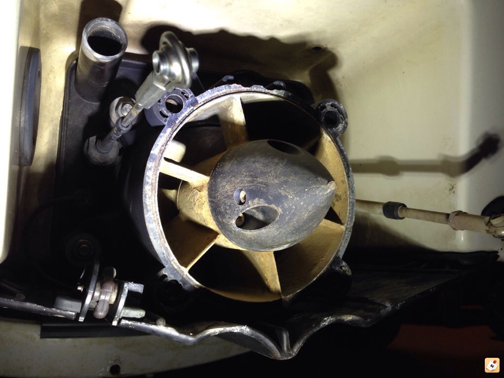

Yeah, I noticed your pump area looked pretty grimy for some reason but that doesn't hurt anything necessarily. About the only thing you might consider doing soon is changing the impeller shaft bearing oil, not sure how the impeller and wear ring look like. Hopefully your primary nozzle screws/bolt threads aren't corroded in their threads..
Impeller is bolted to impeller shaft in pump housing. Alignment is important for not to strip your driveshaft from splines I think.
 But someone with more info will correct me soon
I see. I guess the connection between the drive shaft and the engine output is "soft" connection then.Well, i'm no expert by any means here, but I would think that if your impeller shaft isn't bent the impeller should be pretty centered in wear ring. Of course the wear ring and pump housing must be ok. Maybe if your engine alignment would be way out of bounds the driveshaft could bend the whole impeller and pump assembly in wrong position. But even then i'd think you'd first lose shaft splines from one or both ends of the shaftBut someone with more info will correct me soon
I am reading the manual trying to figure it out :-D
I guess if I take off the pump housing screws the pump will just slide off?

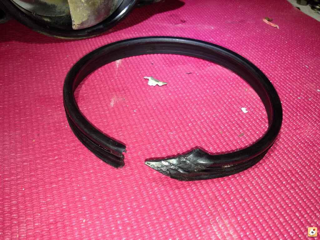

Pump should slide off if previous mechanic put the neoprene seal between pump and hull. Sometimes some people put rtv or other sticky stuff to seal the pump and it makes it pretty hard to take it off.

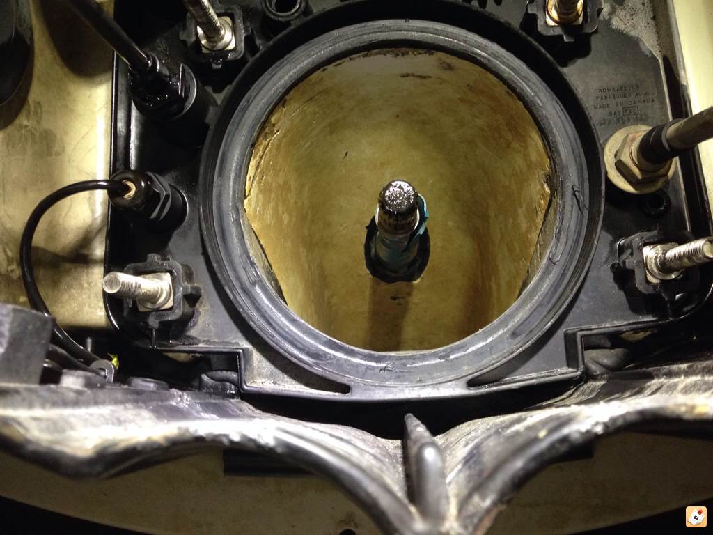

	 To remove driveshaft, it would probably be easier to remount the pump temporarily because the stainless steel seal carrier ring that seals against the carbon seal must be pushed aftward against the pump in order to remove it's retaining c-clip from it's groove in the drive shaft.  The pump will hold the shaft and help to keep the shaft from sliding aftward as you push the stainless ring to reveal the c-clip.
