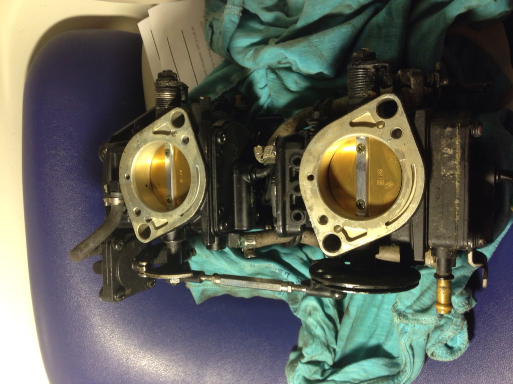

I got the fuel line off and now taking a break with kids back home.
Some fuel came out of the carb. I put a big screw to cover the fuel pipe opening. Do I need to do more to take care of the fuel pipe?
I would need to read that section, (and can't find the reference to it) not sure what the intent was other than it needs to be cut loose in order to get your cylinders free to move when your connecting the rods to the pistons on re-assembly.Thanks. I guess the pulse line is hiding behind. And I can remove the carb assembly out loose and then disconnect the pulse line? Yes, it's hiding in back
Also, in the manual, I read "cylinder alignment". Does it just mean to alignment the manifold with the exhaust pipe? No special things I need to be aware of, right?
So, carbs are off now and the exhaust is removed?
