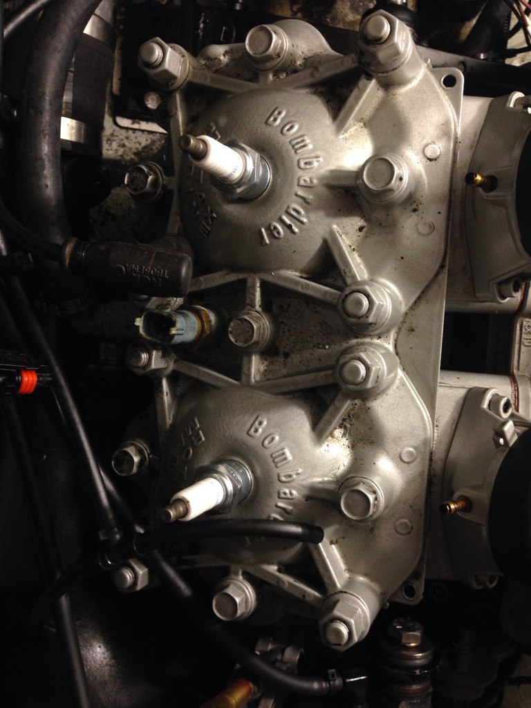

Opening the head right now.
Do I just unscrew the 8 nuts with thread exposed? Checking the manual too
Edit: do I need special tool to take the piston pin out?
Edit: ok i got the instruction
Yep, you answered your own question. Atta boy! Where's Sportster hiding anyway's? It's probably nice down there and he's at the lake for the weekend.
Those head bolts coming out ok for you?

Hey. Do I need to just put the nuts back. I hasn't open the head yet.
