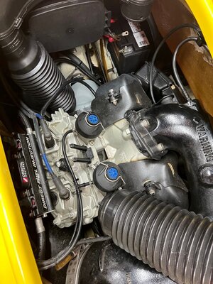

Looked over all the lines and nothing appeared brittle or rotted, however, I found one line unattached, next to the battery in the pictures. I was thinking this could be a vent hose for the battery, can someone confirm? I followed the hose and it goes to the front of the ski.
I read that the grey lines were always suspect, and should be replaced; can anyone confirm that the hoses I have still attached are these grey lines?

Good deal on the vent line, I looked around for a home for the line and couldn't find squat. I didn't see a vent on the battery, but will now double check before I bungy the battery down.
So the DI doesn't have these bad gray lines then, good to know I presume!
I thought I read to replace them on the DI, must have been a different model, my bad...
I can't say what you have on yours. LOL The DI has a different fuel system than the carb skis.
No, DI does not use the gray Tempo fuel lines.
Yes, that is the battery vent hose.
I would change the inline oil filter for the injection oil and verify you are using an API-TC Full Synthetic oil.
Yes, you should change the jet pump oil and the counter-balancer oil if you are adventurous.
I worry about the counterbalancer oil. If it has never been checked or refilled over the years and that is highly possible a small leak can leave that chamber dangerously low on oil. It will not be an easy job on the DI as access is an issue.
