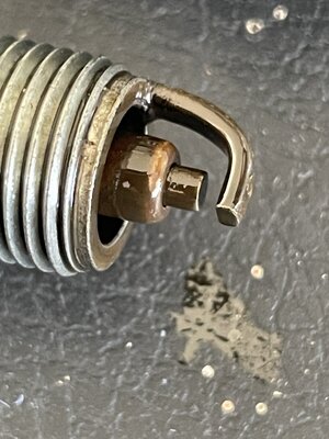

Added a bit of premix in the plug holes, installed plugs, and tried to start. It fired up for a few seconds. I have repeated this probably five or so times thinking the pressure lines would clear out the old gas. Still noting. Each time I'd look at the plugs and they appeared wet. But it's a funky wet and doesn't really smell like gas. The wet plugs would not even catch fire with a lighter either; just a thought to try. See plug pic

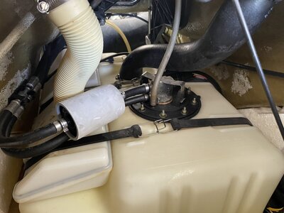

So wondering what I should do now. There are no messages in the guage display. Perhaps the fuel filter (see pic) is gummed up/full of crap? Actually, it may be the original filter as it has factory crimps on it. From the gas tank, this is not high pressure, correct so easy to swap out.
