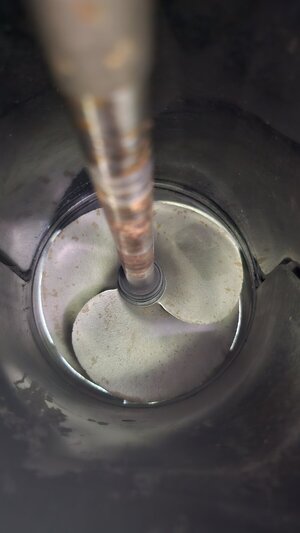

I think your on to something! Guys I work with told me today to climb under and take a look so I did. I'm guessing seeing that much of a gap isn't good.. when I grab the prop it does have a little play up and down, not sure if that's normal.
I've attached a photo, hopefully someone can tell me if my wear ring is shot.
Had the it on the lake today for about an hour and once it planed out it ran great. Slow down and would have a hard time getting it up and going again. Full throttle is was comfortably sitting around 5800-6200 RPM.

According to the shop manual, clearance should not exceed 1.0 mm from the center of each blade to the wear ring.
