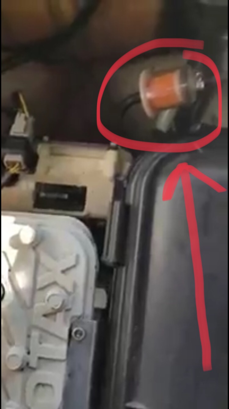

Did you add this fuel filter ?
If so, remove it because it causes fuel restriction.

I had replaced the filter minutes to that prior to taking the idling video (which was after the water video when i got it home) The selector valve is the only thing i have not replaced, but my biggest confusion is it runs worse after i went though and cleaned and replaced everything in the carb. I know everything is where it should be, and the fuel filter inside the carb had alot of crap in it.
