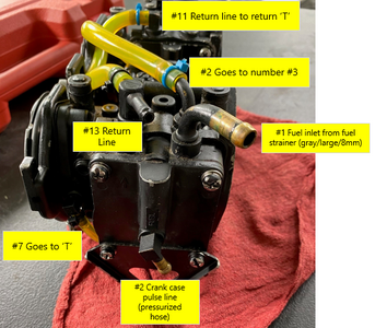

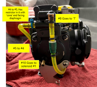

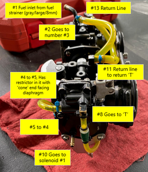

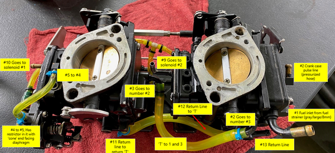

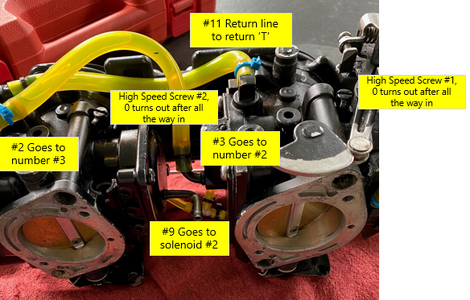

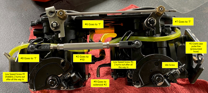

Hello,
Long time lurker, first time poster... Have a '98 GSX Limited and had to rebuild the engine a bit over the last few years. Without going into detail as to why it took 'a few years', upon putting it back together, i had a VERY VERY VERY difficult time finding any sort of hose routing for both fuel and air lines, i.e. what goes where. Nothing is straight forward enough to just say "this nipple has a hose that leads to this nipple, etc.". There are also more carbs than i care to mention for these things, and not a single one of them looked 100% like mine. So i took the liberty to attempt this based on a handful of YouTube videos and searching on this forum. There is a chance that i am wrong but i attached the diagrams below anyways, in hopes this will help others in the future. Please let me know if anyone catches incorrect routing as i am still 4 days away from finishing this up (waiting for a shipment before bolting these on).

You do not have a 1998 GSX, you have the one year model, 1997.5 GSX also known as the Grey Ghost.
It was a mess because seadoo had to meet strict EPA regulations and it had a lot of problems.
You need to cap the Solenoid feed and leave the two small nipples #9 & #10 open for the carbs to work properly.
See this thread for a better explanation... 1997.5 GSX Limited Brand new motor help!

Thank you very much mikidymac! I just read the whole thread. I hope my photos save some people a bit of headache in the future.
