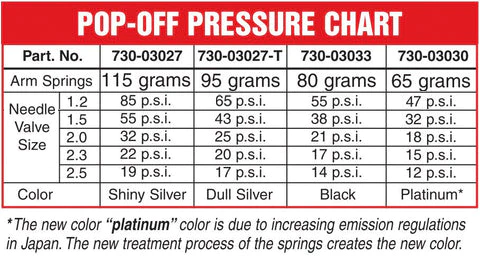

On a similar topic, the standard OEM Mikuni Super 38 rebuild kits come with two springs: a 115g and 65g. Mikuni's chart isn't very helpful, to me at least, as I cannot discern any color differences among them in the kit. Can anybody confirm the longer of the springs is the 115 gram?
Is 80 grams the correct spring on this '95 XP?

80 gram is the correct spring, 1.2 needle
