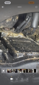

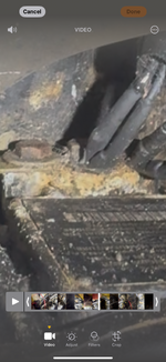

Ccan you post a picture? And please also provide final repair of intercooler?
Sure! I have a video but cant upload a .mov file. im thankful that i found it because in water it could have caused major damage
More pics of IC when i get it out
