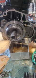

The encoder wheel looked like it has a 2 tooth gap which I assumed is normal for it to know where number 1 cylinder is? 20250717_171301.jpg
Not a great picture but the gap is around the 10 o'clock area
When I rebuilt my engine last year, I remember reading about checking the gap between the encoder wheel and the sensor (all of the tangs); did you do that step? Too wide of a gap will reduce the voltage signal since this is a variable reluctance sensor. Signal strength needs to be 500mv minimum, and you really need a lab scope to analyze the signal properly. Once you've verified the ECU is getting a good crankshaft position signal, and if it's still not starting, you need to perform all of the standard steps for a no start condition ... check spark, fuel, etc.
