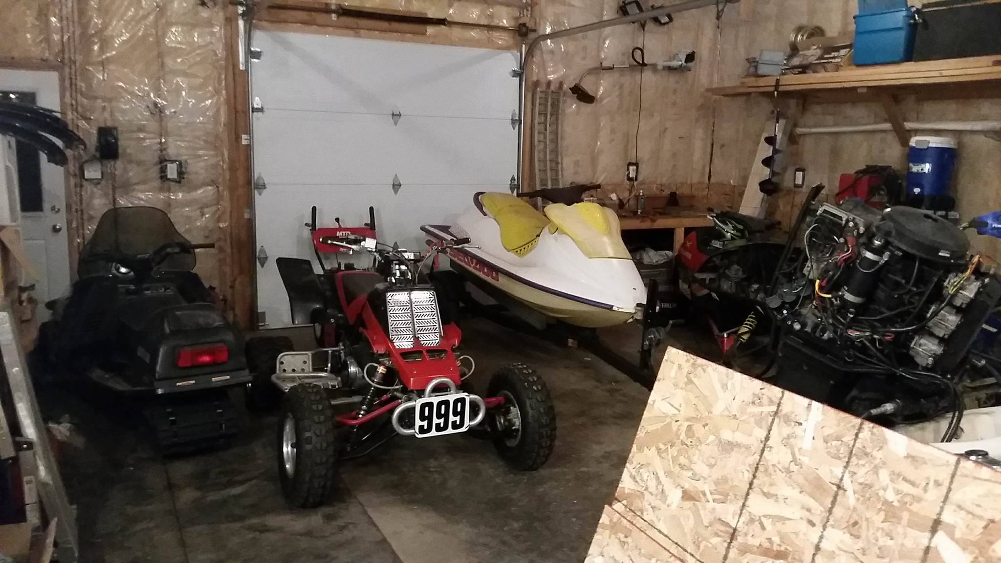

For those that enjoy pics... herers the only one I can find at the moment.
