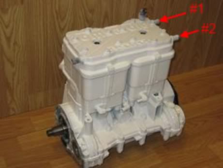

Ok...787.
Here is a pic of the 787.
You want to pinch off hose #2. This will keep the antifreeze from exiting the head through here. You want it to run to bottom of engine, not out this hose.
You will remove the hose at #1. This is where you will attach another short length of hose you have lying around and will be pouting antifreeze into the engine through it.
You will also notice a clear plastic hose running out from the bottom of the engine and off to the rear of the ski (1/4" to 5/16" inside diameter hose...smaller than the hoses at #1 & #2). This is where the antifreeze will be coming out. The manual tells you to pinch this hose off, but you don't have to. Pinching it off just makes it easier for you to notice the antifreeze has gotten through the engine.
So, pinch off #2, pour antifreeze into funnel and hose you attached at #1, look for it to drain through clear platic tube running from bottom of engine. If you notice antifreeze pouring out onto your garage floor/driveway, then you just missed it draining through the clear hose and you can stop.. Job is done...unpinch hose #2 and reattach hose #1.
