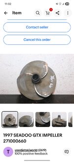

Hey whats the main difference in these styles of props? Obviously one's more straight edge and ones swirly LOL. Do you get a little better hole shot with the swirly one?1000009077.jpg

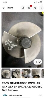

Two completely different sized impellers with a wrong listing.
99' GTX is a 155mm and the 96" GTX is a 140mm.

The seller is pretty adamant it was off of 97 GTX and it says Sea-Doo stamped on it..... I wonder if it's maybe off of different model that had that style of impeller and was put on to his his GTX. Long story short I'm looking for a little better take off when pulling tubes....I've got a solas 16.5/23.5 which is deadly all around but cavitates a bit only when pulling a tube. I got a wiggle back and forth A LOT to get some bite when I got big people on the tube LOL.
And he only wants 40 bucks for it which why I was interested. What's my cheapest option for a little more bite when pulling tubes (besides finding skinny people)?
No, 1996 and 1997 used the same impeller.
From what I have seen with Seadoo only the 155mm pumps came with the swirl impellers but I could be wrong. It is also been damaged and someone just bent and ground the leading edge which isn't good for holeshot either.
