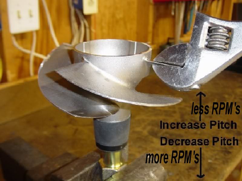

You're on the limiter. You were on or near it before you upped the intake. Add a bit to your oem prop and try it again. Personally, I'd add 2mm...and hope I could see 8k.

If you're gonna get into modding your ski...take the hit and get a prop removal tool, then tweek your own. You'll be able to see where you're at almost as fast as you can do the work. Personally, I can remove my prop, tweek it and replace in less than an hr. If you had access to a work bench/vise at the lake or where ever...the way to go. Some have even welded the prop removal tool to a plate and bolted it to the side of their trailer...then they can do all the work at the ramp.
The oem props are a dime a dozen. Learning how to tweek an oem prop is the way to go. That way...when you do go down the 14/19-15/20-15-22 road...you'll be able to maximize your own with confidence and save yourself time and money by not having to send it away for a professional treatment after every single mod. Once you get where you want to go...if you ever do...heh....then you'll be able to send it to Dave at Solas for the final prettying up.

...so...adding a coupla mm would mean for you to tweek the trailing edge so that the blade's pitch is steeper by 2mm.
I do my measuring with the prop off the removal tool. just setting on the nose on the bench and measuring from the bench to the blade's tip. I even everthing out first...before counting any additional pich. i also use a sharpie to mark the blades...keeps me from forgetting which one I'm working on at the moment.
One last thing...do the bending with the wrench about an inch up from the trailing edge. Don't sweat a lil mark or two.
Hope this helps.
