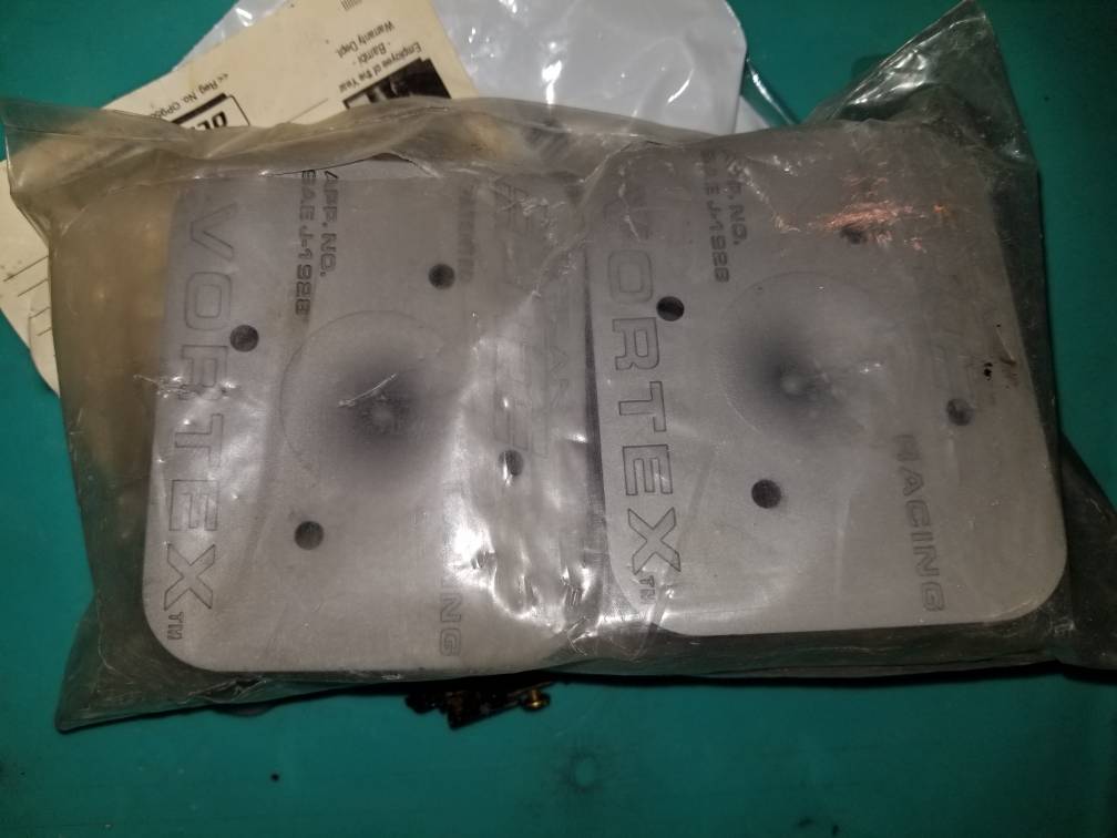

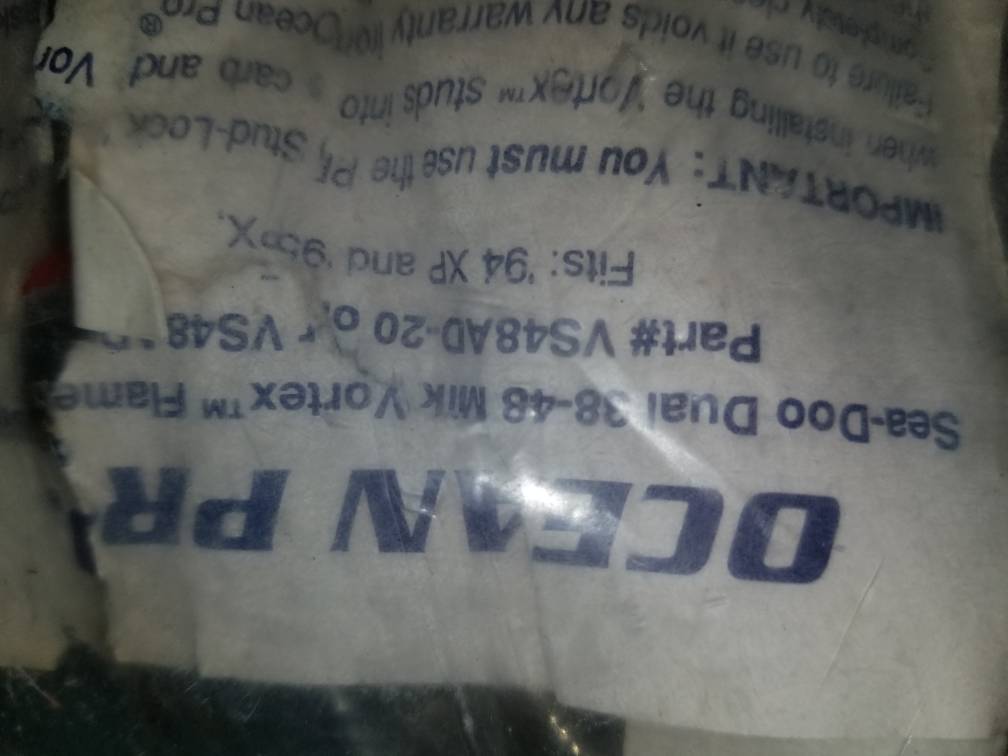

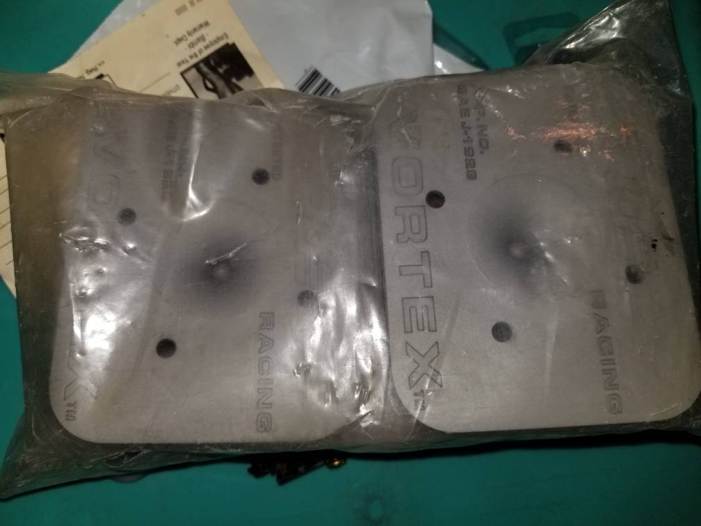

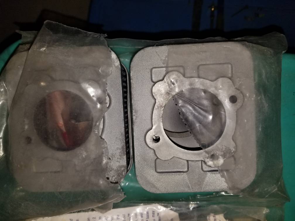

Here are my flame arrestors.
Those do not take an adapter and bolt directly to the top of the carbs with the provided shouldered studs. I don't see any provisions for a support bracket so if it were mine I would be concerned with a support bracket. Some of the early ones had a bracket that bolted to the upper part of the carb body then to the head but I don't have any pictures of that. It issue is that the weight of the carbs and the stress of vibration can crack the intake manifolds without a support.
