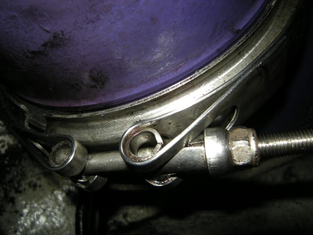

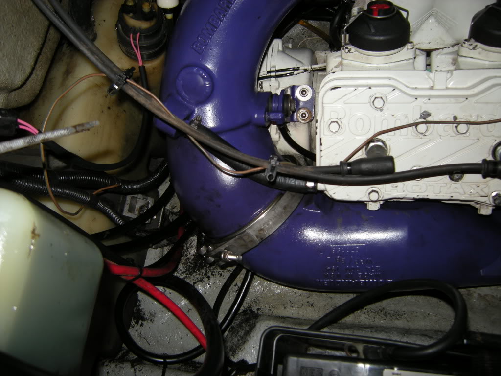

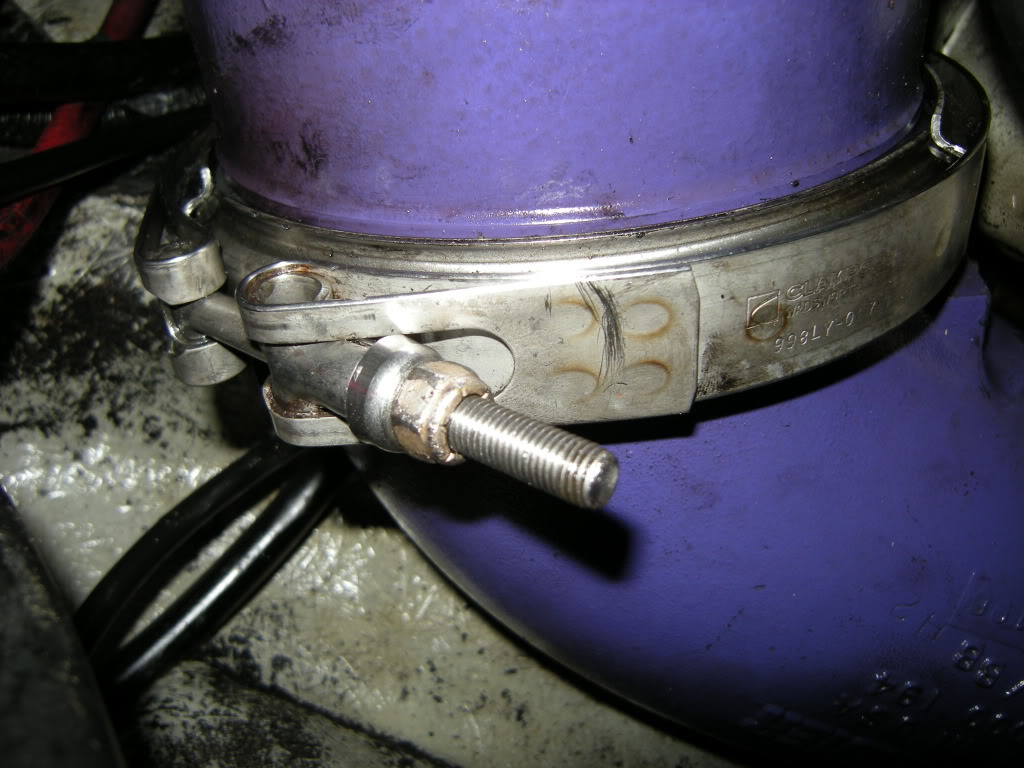

I tried the lossen everything last night and align and tighten the clamp. Also used a generoud amount of Ultra Black. I will post a few pics in a few.
Here are a few pics. Now sure it it shows much. Going to run a run after the re-seal last night, then can get some shots with the clamp off.
Does it look like it is pulled down far enough (I.e. indication of non-properly mated surfaces)?
