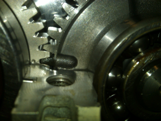

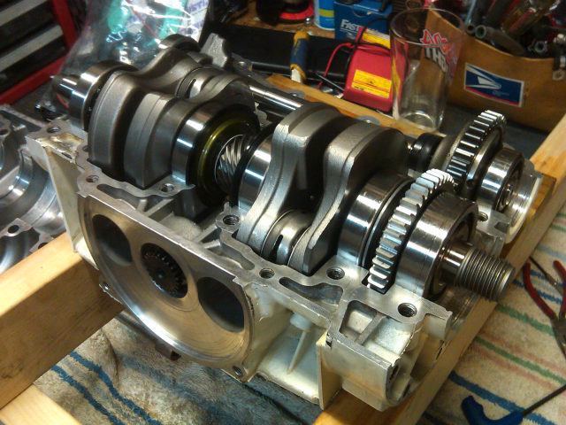

So I started some on my 787 build for my 97 GSX tonight. I pulled the rotary shaft and changed the seal and inspected the bearings, and installed the new Hot Rods crank and the balance shaft. This will be my first build so Im going to go step by step on here as a source for info for others like me and as a way for the experienced members here to be able to fill in advice and "watch out for" info. One thing, i know there is a timing of the crank and balance shaft, but I cant seem to get that perfect alignment. Below is a pic of the best scenario I got. Hows this look?
I will keep posting pics. And progress reports as I move forward. Wish me Luck!!
rotate the C/B 1 tooth c.c,. From the pick, you'll see the "dot", on the C/B, above the "knotch"
