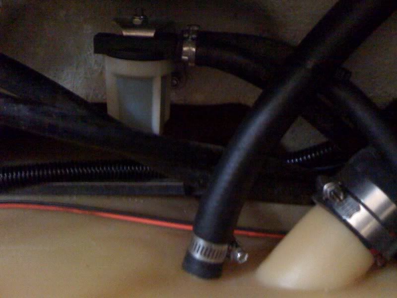

I found what i believe is the fuel filter, (i'll post a picture).

Is this the fuel filter?
also, replace the o-ring. Another member, was troubleshoot'n his performance issue, and come to find uot, that filter, was missing the o-ring.
