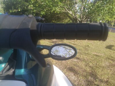

So I was looking for a stockish looking replacement for the Seadoo grips that was economical, I buy and sell skis so price matters , original grip sets are still out there but they range from $25 -35 a set..
I saw these on Temu and I ordered them , I also ordered black Aluminum end caps and a big bottle of super glue, the grips are a tad long but they will force on to the bars and become the correct length.
You do have to remove the plastic retainers inside of the handlebars , I screwed the scew and washer in part way , clamped a set of vise grips behind the washer and hammered the inserts out, easy peasy.
You do have to cut the ends out of the grips which I did with an Exacto knife, , I found it easier to push the grips on and then cut the end out using the inside of the handlebar as a guide , add some super glue and install the grips, add the end caps and you are done.
I ordered six sets , the end caps and the glue for around $40.00.
I included the link to everything I used below.
