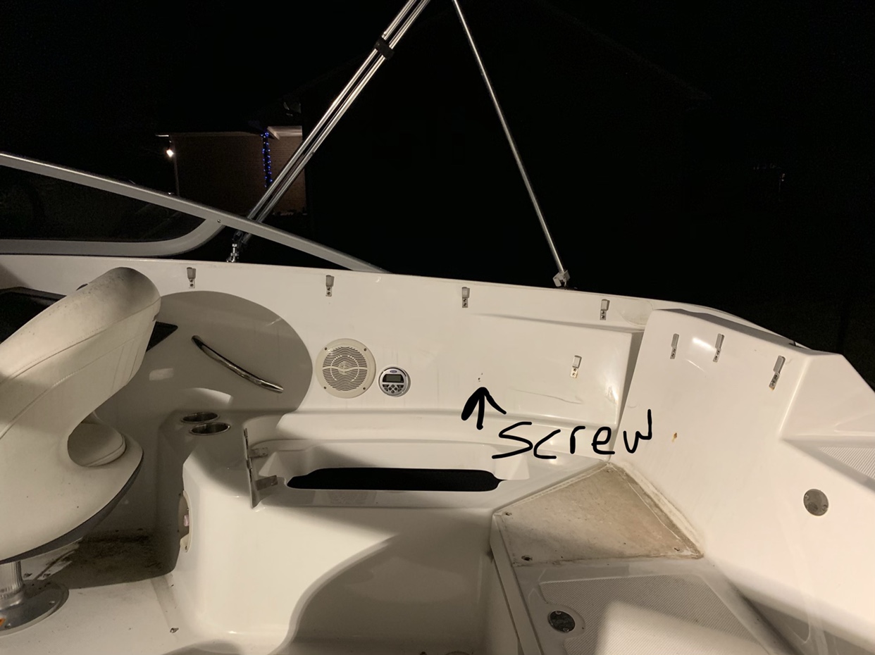

How do the side/back wrap around upholstered panels in the cockpit come off? It looks as though there is some metal bracket riveted to the boat. The service manual does not disclose even though there is a diagram.
Feel along the bottom edge until you feel a gap in the edge. Push the vinyl up to reveal a Philips screw. Remove the screw (there may be two along the way) and push up on the upholstery.
Also, the very front of the two rear side cushions are held in with a plastic push river thing. Just pull straight out on that front point and it will release.
You guys are awesome! Been looking for awhile but only could find the older models. For clarification, the wrap around slides on those hooks? (hard to see)
Yes. If they have never been removed, they may be a little stuck with the original glue holding the foam to the plastic seat back material.
