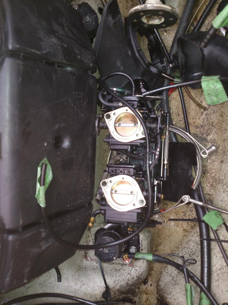

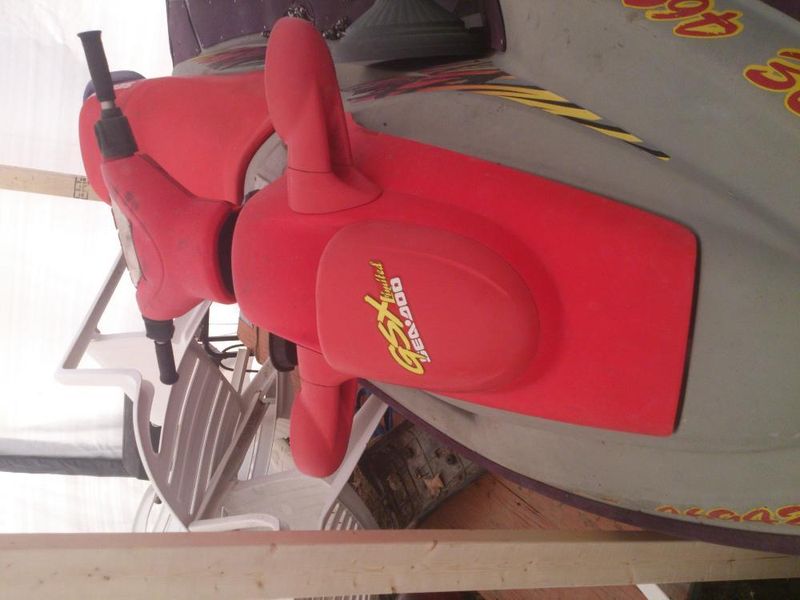

Ok so with all that said, does this thing have any potential? I am hoping to go and look at it this weekend and see what kind of condition it is really in, also is there anything that I should be looking at before purchasing it.

cases don't look cracked, but check them carefully if you can.

I've done lots of 951s, but i HATE it when they come already apart. If i saw this, I'd start the bidding at $150.
how many stainless bolts are you missing? how many parts are gone? no thanks.

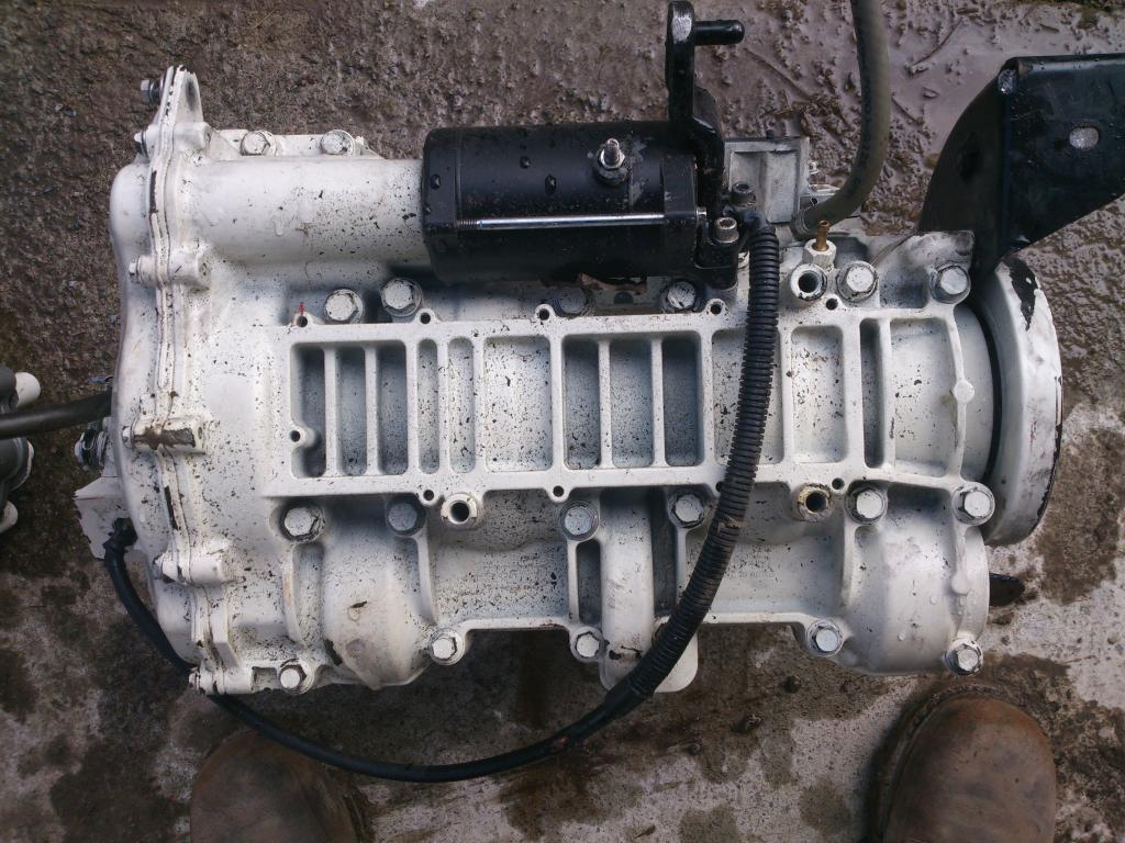

even the black starter tells me someone's been messing with it.
that's the rare white 951 engine... also a no thank you.
also. why is the starter wire still attached to the starter?!
and who the hell unbolted the PTO adapter?
Who took this thing out? a blind monkey?
it gets a NO from me. I'd buy it for $150 and part it out.

This is a little bit more than the average shade tree mechanic can handle, I wouldn't touch it unless you weren't in a rush to get it running and had a big $$$$ pocketbook. You will be pretty much building the ski from scratch and the outside isn't even clean either. I would take it at about the free price range....maybe

The 1998 Gray Ghost was the first year of the 951 and was a one year deal because the white engine was junk and seadoo knew it. I would be surprised if any of them that are stock are still running from what I hear. In 1999 seadoo made major revisions to the 951 and it is the "silver" engine. They are much better than the white but still have their issues. At $400 I just do not se it being a good deal in the long run. If it was all together but locked up and the rest of the ski was clean it might be ok because you could always exchange the motor for a rebuild but like the squirl said you have no idea what is lost or missing.

The above is correct. The 97.5 actually had the white engine and a few 98s had it as well. The engine had carb and reliability issues. It is similar but not the same as the 98-02 carb 951.
The black starter is not OEM and is junk. OEM is the only starter I trust. Things last forever.
You'd have to be 100% sure all the gauges, sensors, VTS, steering, etc all worked.
I have more than enough spare parts to throw this back together, but I'm not interested.
Seats, hoods, carbs, pipes, jet pumps, etc.
I just have a hunch that your opening a can of worms here. I hate to see people waste money.
Even if this was next door to me, not a penny over $150.
