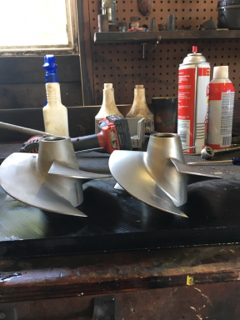

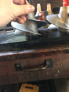

I decided to start a new thread once I had the complete facts. I had stated in another thread about rebuilding the pump on my 94 GTX and noticing a loss in power. I naturally assumed it was due to the impeller I purchased from SBT. A refurb. They sent me an impeller with a different part number than stock and told me it had been re pitched to the stock pitch angles and it would work just fine. So I got ahold of some pitch templates and tweaked the trailing edges to get them closer to stock but it still wasn't 100%. So I decided to purchase a good used impeller. I removed the SBT refurb and compared to the stock one and saw the difference. The stock 94 GTX impeller part number ends in 280. The one SBT sent me is a 400 off a right drive on a 94-95 Speedster. Although the leading and trailing pitch angles are correct the difference is in the length of the vanes or the distance the vanes go around the impeller. The 280 has a leading edge that starts sooner or thus ends up having a longer vane. Pics below show what I mean. Moral of the story is I could've re pitched this thing till the cows come home and it wouldn't be right. SBT is selling garbage and doing shoddy work. This is more proof of it. They're customer service and a technician argued with me over it and they're wrong. Do not trust these people they should not be in business.
280 stock on left 400 on right.
280
400
I couldn't agree with you more. More and more of these reports keep coming about them but they have gotten so big they don't care and unsuspecting people looking for a cheap price keep getting bit. All we can do is to keep spreading the word about their inferior parts and customer service.
I bought one from them for a 05 Rxp and they swore up and down it was the correct one but where the impeller shaft meets the back of the impeller it had a groove that allowed the impeller to bottom out on the housing when installed.I sent it back and got a used one.
