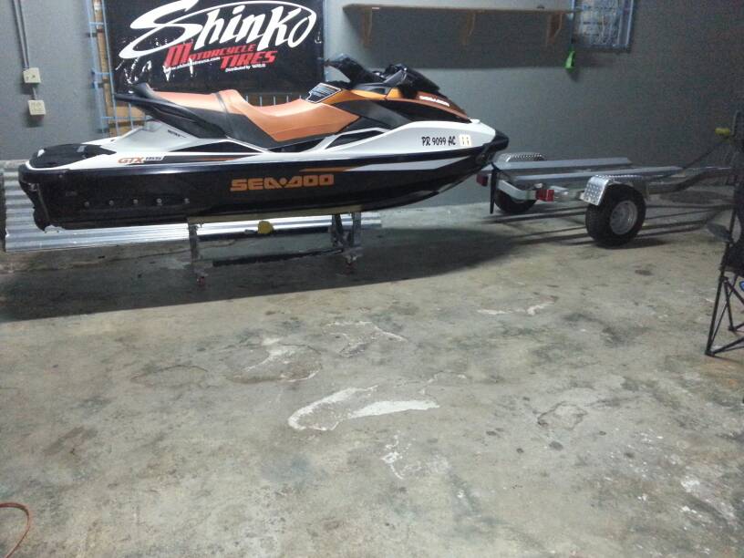

Due to our current situation, I (very unfortunately) don't have covered storage for my ski while it's on the trailer (trailer is a double). I do have the cover on it, and I was ok with that when I was riding it frequently, but I know it'll probably be tucked away for the next 4 months or so, and I'd like to slip it into the garage. I have a dolly (linked below).
What I'm nervous about is the process of sliding it onto a dolly and getting it positioned on the dolly. What is the balance point of the ski? I obviously want to center the ski on the dolly for the best stability. The issue is that it's 57" bunks with a 133" ski. I have a GTX Limited iS 260 and it weighs over 1000lbs with fluids in it, so if something starts to happen (like it start to fall/tip) it's going to keep going - as there's no way I'll be able to stop it, even with the help of another person.
Do I just center it on the bunks? Or center the motor over the bunks?
I know the general process of placing the dolly behind the trailer and sliding it backwards.

the engine is the bulk of the weight, basically center it with the engine section 100% over the bunks, and you'll be just fine. I've literally slid every model of ski from a trailer to a dolly over the past 10 years (from 96 xp up to 08 RXTX) and I've yet to have one even come close to falling off.
FWIW, i'm STILL apprehensive every time, but it never falls. The hulls are very well balanced.
note, when its slid over and centered, the front will usually still be touching the rear of the trailer bunks, so you'll feel more comfortable knowing its there as you slide it back that it doesn't start to tip..., it won't, and you'll be there saying.. 'wow, that wasn't so bad'

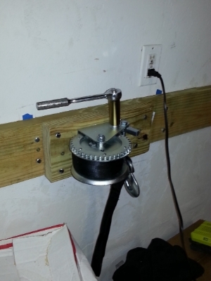

I actually side mine over by myself 90% of the time, I use a wall winch when the trailer doesn't have sliders and it works awesome, slides it over 2-3 inches at a time...and its helpful with a big ski to have somebody pushing the ski stand forward as your sliding the ski back, when i'm alone I have to stop winching and kind of kick the stand forward maybe 2-3 times before i'm comfortable with the positioning.
without sliders or a wall winch i'll admit, it takes two strong backs to slide over a full sized ski...
