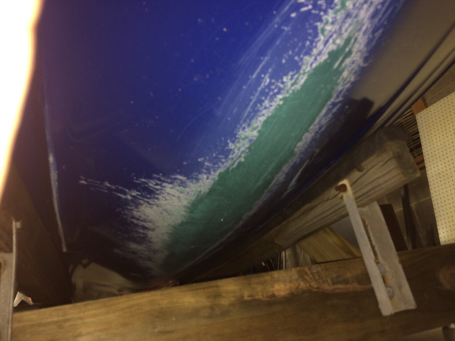

For those that were wondering, here is the bottom of the GTX. It gets beached quite a bit, which is why this looks like it does. The picture makes it out to be a little worse than it is...

Honestly, until this can be seen from the waterline I won't touch it. For now it's just not worth the effort.

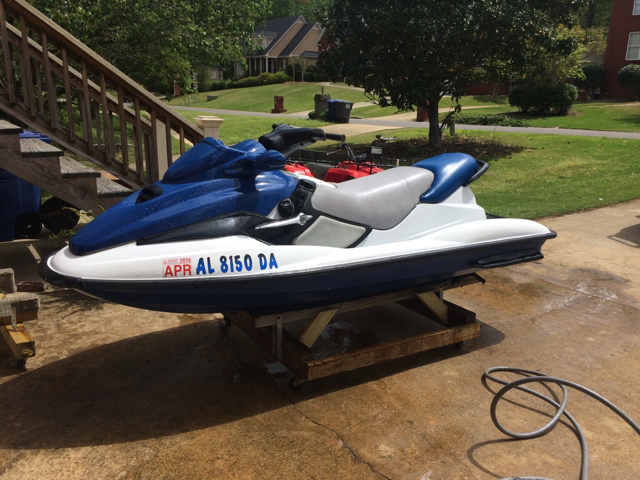

A little progress the last few days: I got a good used starter bolted on and she fired right up after the winter hibernation. I wheeled it outside for a wash:

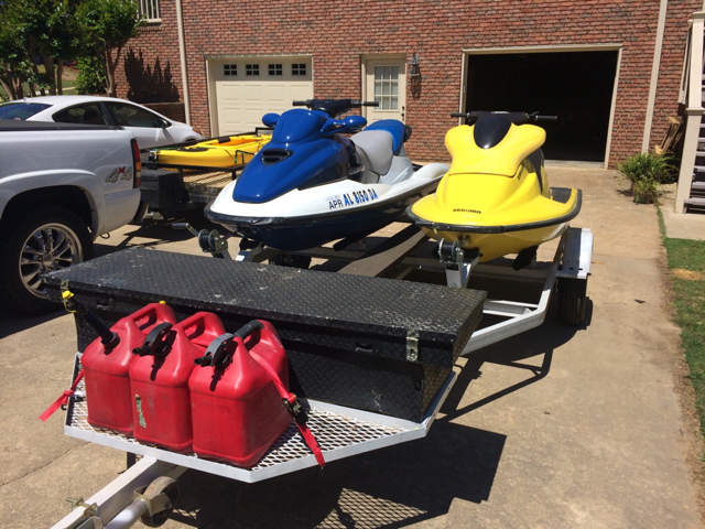

The XP made the trip so I could have a full trailer, hence the lack of registration numbers or real seat cover :lols:
And no, we didn't take a trailer just for a kayak... there's a lot of lumber underneath it.

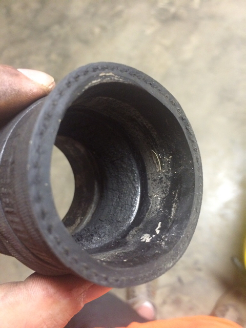

Small update: the rubber exhaust coupling has been replaced, the water regulator has rebuilt and the water lines have been blown out. It appears that the stainless clamp that holds the diaphragm let loose and caused my issue. The exhaust coupling got a little warm...

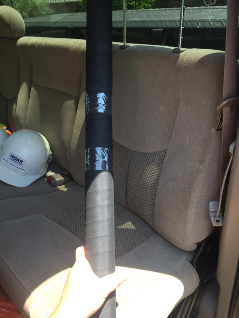

Being that I have 5 skis in my stable, all with 20ish year old exhaust couplings I broke down and bought a new piece (Gates 24032 for those interested) to replace them all. And by broke down I mean broke down and cried since this junk is $18/foot and O'Reilly couldn't cut a 3' piecee :willy_nilly:. Gotta pay to play I guess.
