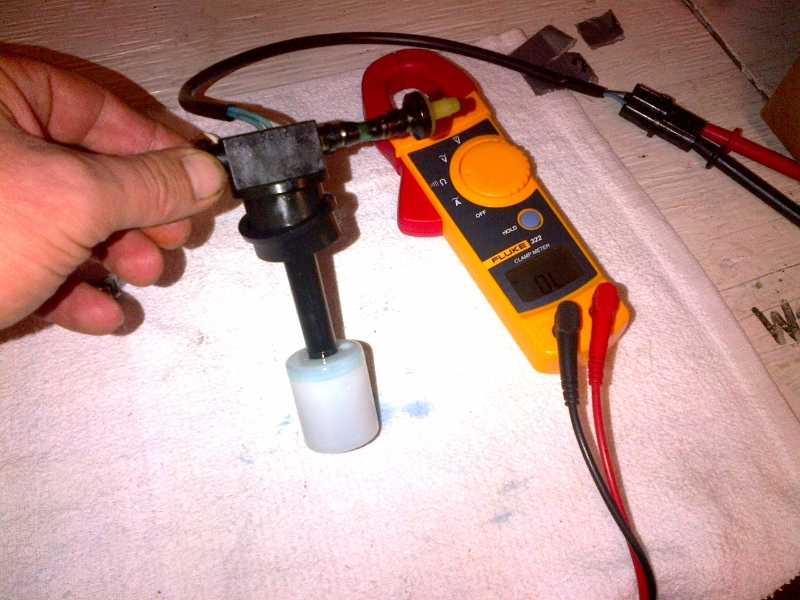

When submersed in oil I get a reading of 9 ohms on my "bad" sender, I have a "good" sender from ebay that gives me a reading of 13 ohms in the same condition.
I don't think my "good" sender is going to fix the problem I had...

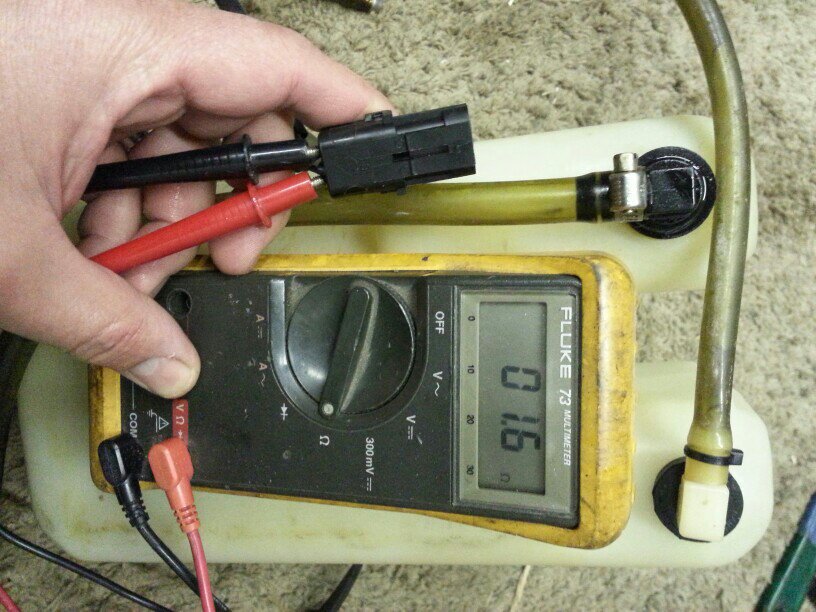

Nice. What about in oil? I get different readings when submerged.
The first pic is as if it is in oil, I am holding it upside down so the float is at the top of the white column, as if the column was full of oil.
The oil doesn't have anything to do with your meter reading, the white column is just there to retain some oil around the float, and fills and drains through the small hole in the bottom. That way when your bouncing around the light doesn't flicker steady. I checked some of my other skis and got reading from .3 to 1.2 (I think my meter reads at a different scale) and they all work.

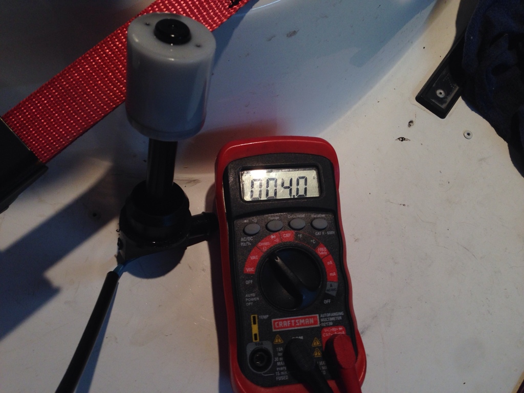

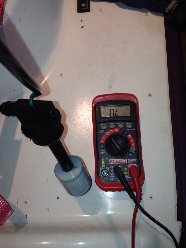

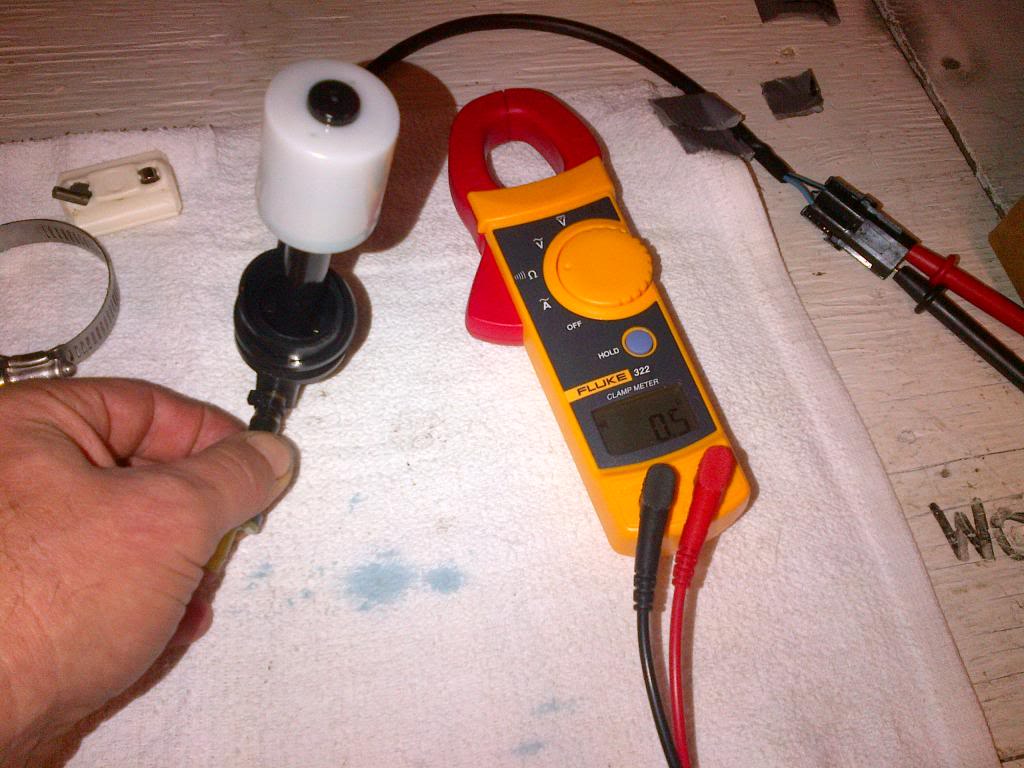

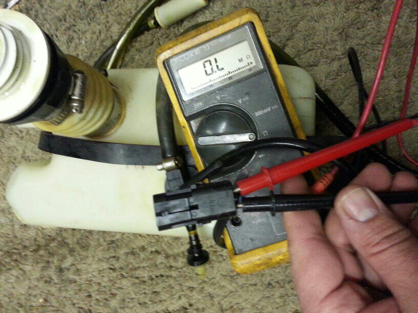

Ok, rechecked today. Phantom readings last night, couldn't reproduce 9 and 13 ohms. I am sure it had something to do with my connections on the test leads.
At any rate on to the results
Bad sender, down =open
Bad sender, up= 4.0 ohm (out of spec)
"Good" sender up , .6 ohm (in spec)
Both my 96 and 97 manuals show a closed circuit in oil to have a max resistance of 2 ohms, perhaps my 97 GSX gauge is more picky about that spec than y'all's?

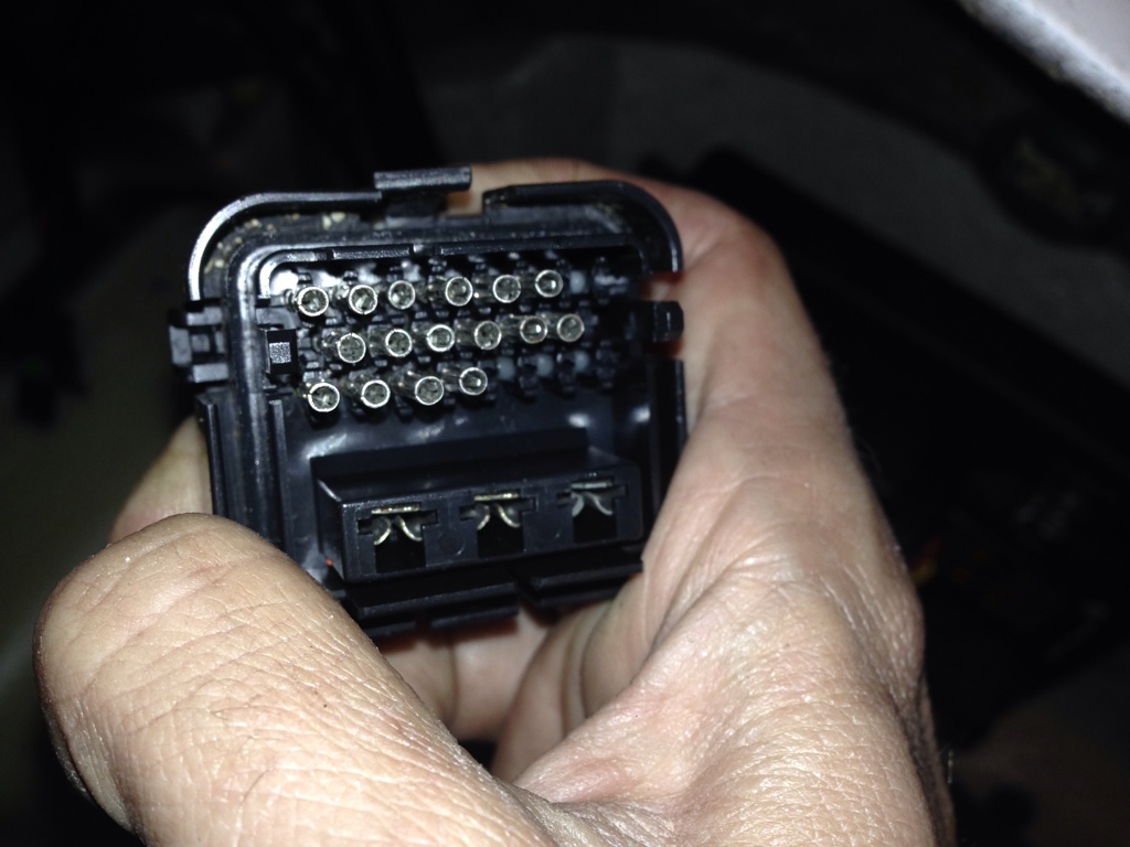

So pulled the meter out and checked resistance from the oil switch (tested good)
Then I shorted the wires at the plug (on the MPEM/ gauge side) and still no luck.
I then followed those wires to the MPEM connector and was planning on checking continuity between the connectors.
What I found was the cause of all this nonsense:
See that pin, third from the left on the top row? It is pushed in, away from MPEM. It is the blue wire coming from the oil switch. I was able to move that pin to the correct place and reinstall the connector.
All is well now.
