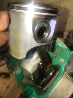

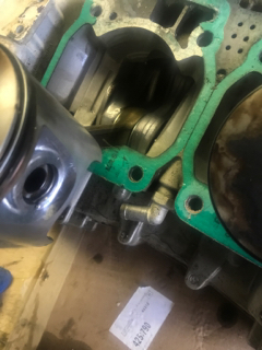

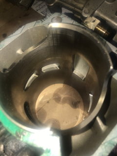

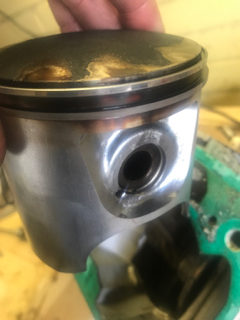

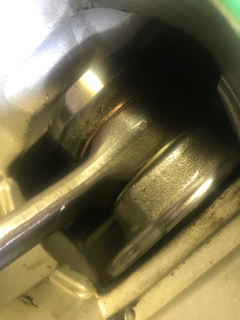

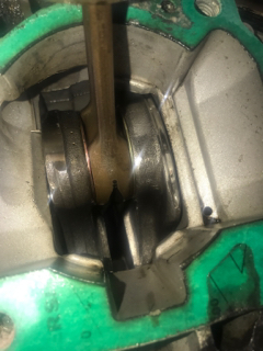

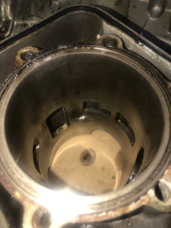

USCG96gsx Member Jul 23, 2017 #1 So I got the top pulled and no scoring on the positions or cylinder walls. Spun the crank and I see no rust or sand. Thoughts? .jpg[/IMG]
jjsinaz Active Member Jul 23, 2017 #3 Sorry I must have missed it...why was it locked up? Engine looks really good inside
USCG96gsx Member Jul 23, 2017 #4 No clue couldn't get it to crank, once I got it out got it to break lose and it's like butter now.
jhjesse Well-Known Member Jul 23, 2017 #5 Order a set of rings. Hone the cylinders to break the glaze. Put it back together and call it a day.
