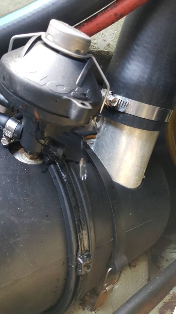

When I repaired my starting issue, I was running the 2002 GTX-DI on the hose and the pressure regulator was leaking. Has a small steady trickle. I'm new to jetski's so I don't know if it's supposed to leak when running off of a hose. Naturally I would assume that it shouldn't leak at all. Thanks for your help.
Yes.... should not leak.... will have to be pulled apart, cleaned and possibly orings replaced. Grab a free manual from www dot seadoomanuals dot net
Maybe you had to much pressure from the garden hose. Dry it all up and take it for a spin. If water is present, then proceed with rebuilding it or replacing
The jet pump will make as much pressure as a hose. If it is leaking on the hose it will be leaking at full throttle.
Pull it apart. Typically the lower clamp rusts out.

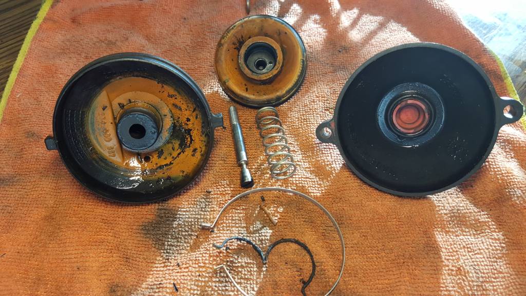

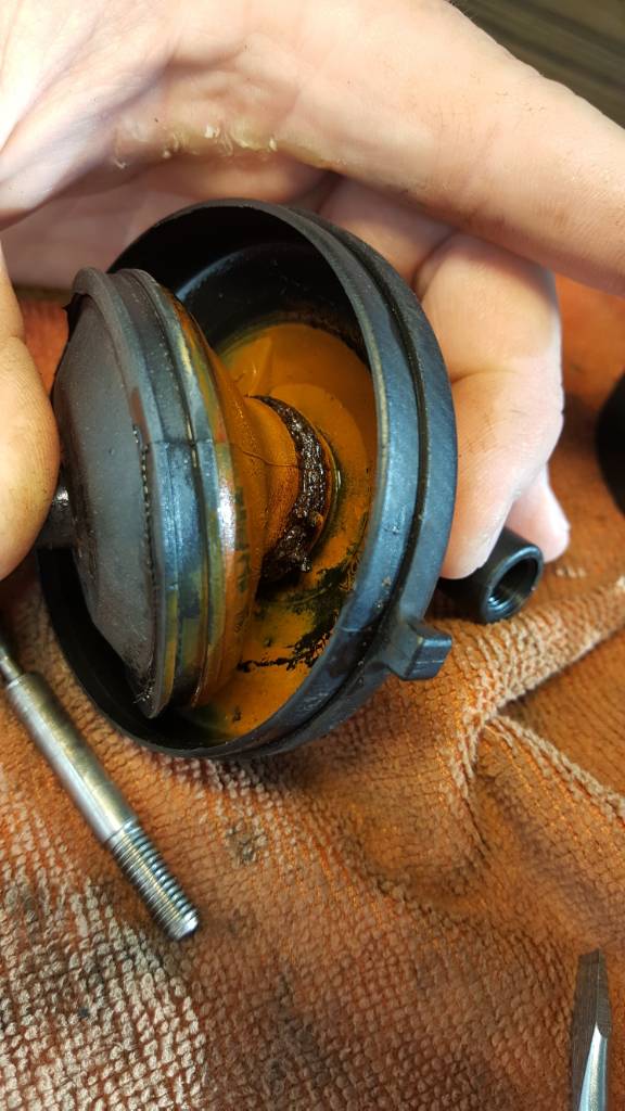

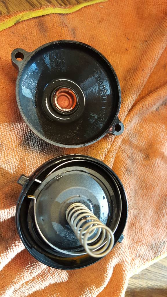

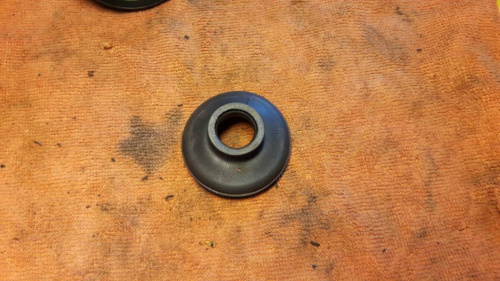

Pictures from the tare down, mikidymac you were correct. Lower clamp so rusted it crumbled. Would I need to purchase a new bellow along with a clamp? The bellow has a small mark/indentation that doesn't go through. Also where do you get your parts from? Online the bellow is $40 I didn't know if all parts sites are the same price.
If the bellow is ok you can reuse it as long as there isn't a hole in it.
Some people use a small zip tie and melt the head so it won't cut the bellow. I have also used stainless safety wire.
mikidymac thank you again for your help. I used a zip tie around the bellow and reinstalled the pressure regulator and no leaks. Thanks again everyone for your suggestions.
That bellow has a hole in it, common issue from that clamp. Get a new bellow and use a zip tie on the bottom and but the extra off the tie flush.
