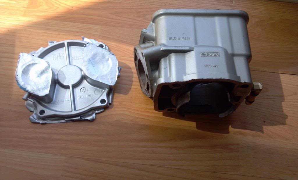

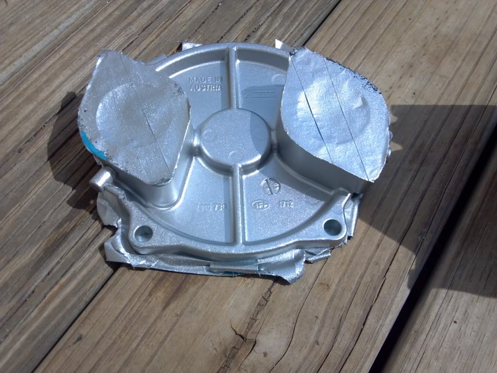

I would like some input on my paint color for the engine I am putting in my XP. I am using Rust-oleum high performance wheel paint. Judging by the cap I was expecting it to be close to the color SBT uses on rebuilds, maybe a little more metallic, well it is..a lot more metallic. I painted the rotary valve cover to see what it looks like. At first I did not like it at all, to me it looked almost cheesy or cheap because it is so shiny. It is starting to grow on me, I'm beginning to like it. It looks good in the shade but in the sun..boy is it shiny. What do you guys think? too much?
Cylinder is SBT color..
If you want very close to the OEM silver you want to use duplicolor HPW 101. It has a little metallic to it and it looks awesome. Some where on here I posted pics of my speedster engines that I shot with the duplicolor. Also you can check my 96 XP thread (in my signature line below) and see the white from duplicolor, it gets a very nice OEM build up.

I have followed your XP thread, and I think I have seen pictures of your speedster engine bay too, it looks great. Ive got a 96 speedster project I will be doing the same with too. Anyhow, Is the HPW 101 a wheel paint? I actually got the idea to use wheel paint from you. The wheel paint I used laid on very nice, and looks great after just a few coats. I was very happy with how well it came out, just not sure about the color. I am considering painting the head and seeing how it looks.
Yes the HPW 101 is a Wheel paint. It's very durable. I would test the Rustoleum with gas to see how it holds up. To me that is way to chrome like, but the metallic looks nice from what I can see. I even think the SBT silver is too silver if that makes sense. This is just my opinion, in the end, it's your project not mine so do what you like best.

I also like to go over everything with a clear coat when I am done. On metallic paint, you need to be sure it is really dry first because the clear can cause the metallic to pull together (called mottling) I would play with semi gloss down to a satin and see what you like best. The clear can help hide staining a little. If you have to wipe the paint down without the clear, you are potentially taking some of the color off which can leave marks. With the clear, this is not as pronounced. I may be a little anal though so just my two cents!!!
