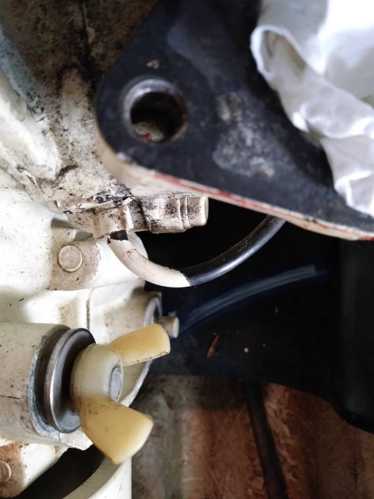

I am changing the oil lines on a 96 GTI 720. The factory lines are clamped on with what appears to be a piece of metal with two tabs on each side. I don't remember my other ski having this type of clamp. However, I do remember these nipples are delicate and will break easily. Without having a picture do you know what I am talking about? What is the best way to get this off without breaking the nipple?
Here is a picture
Just pull on the rubber hose they will come off with it.
Use small good quality zip ties on the new hose.
For anyone reading this in the future... These clamps do pull off pretty easily, but the first one I tried would not come off. I pried and did everything I could think of. Ended up using a dremel to cut it off. With it being clamped on, it left a tab that you can cut without hitting the nipple.
Just saw your message mikidymac. I had one of those clamps to whoever put it on at the factory was highly motivated. He/she went over board with the crimping tool
If you squeeze the ears that stick out together towards each other with needle nose pliers it will loosen them too.
