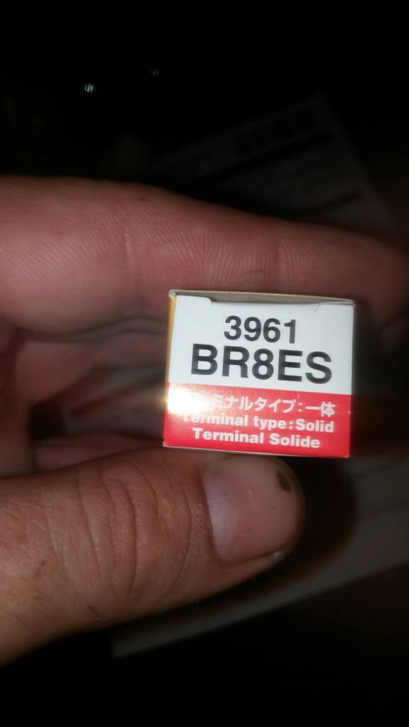

May want to stick with ngk plugs as well
this one has the solid top not the screw top

Yea, [MENTION=73220]1of500[/MENTION] , I had intermittent spark on my spx when I bought it, changed plugs 3 times, cut plug wires, changed wires out completely, finally read somewhere that vibration can loosen the screw on caps even if they're tight and can cause an unstable connection.. Switched to solid tip BR8's, and it NEVER happened again
