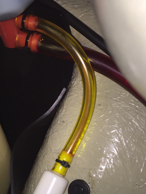

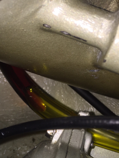

Hey Gents - finally got back to finishing up a 99 GTX RFI that I picked up last year. The dude I got it from thought the engine was seized but with plenty of help on here we found it was just the jet pump that was seized. So while I had it apart I did the following:
1) pulled and cleaned the gas tank
2) new fuel pump, pressure regulator and fuel screens
3) replaced the leaky 2 piece oil tank with a 1 piece and new oil filter
4) new AGM battery
5) new rectifier
6) new ignition coil
7) new plugs
8) used jet pump with about 30 hrs on it - I pressure tested it and it held perfectly
9) rebuilt and cleaned both raves
10) rebuilt the OEM starter
11) replaced the super corroded power cables
12) replaced both fuel injectors with new ones from five-o motor sports
13) greased the drive shaft fitting
14) pulled the exhaust and replaced the gaskets as he said it leaked slightly.
So here's the deal - this rig has 106 original hours on it. The last time it ran was the summer of 2013. I got it from the guy in 2015. I just put 10 gals of fuel in the tank and 1 gallon of XPS 2 in the oil tank. I connected the DESS key and got 2 quick beeps, which I understand is what I should hear.
Question is: what do I do next? Spray storage oil into the cyls? Can I go ahead and see if it kicks over? I think I can do this briefly in the driveway if I start it, turn on the hose, then turn off the hose and shut it down? Do I need to bleed anything? I did not do any compression checks - though I would expect it to be ok at 106 hrs.
Thoughts?
