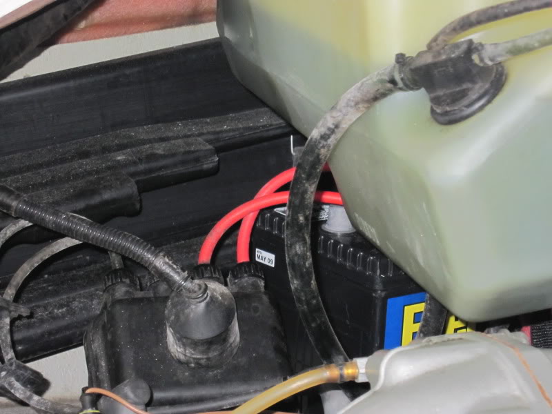

Just to make it easier for you. The starter solenoid is in this box:
finally it was a bad solenoid!! my frien had one in stock. boat runs again and i'm going to deliver it to buyer tomorrow morning.
