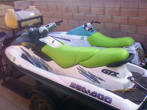

All dressed up and no where to go!
Just waiting for the titles and registration now!
By the way, this is what happens when you go to the half priced upholstery shop and are not specific about the colors!:stupid:
:ack:
Well, no trouble telling which ones are mine at the lake now!
:rofl:
