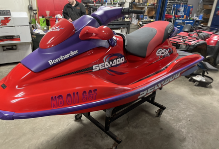

My 1998 GSX ltd has it intact and working…but I’m basically afraid to use it currently, because of the horror stories online about it frying the computer.

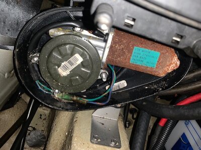

Thank you guys, I appreciate the good explanation. I'm going to open mine up and inspect to see if it's ever had water in it. If it looks good, I'll replace the boot, use the grease on the seal. If it looks crusty...I'm gonna unplug it. I appreciate it!
oh my gosh, I'm so glad I looked. I opened it up and water poured out. It's a mess in there. If I replaced the motor would that be a resolution to a potential problem? Or is it even worth the expense/effort? Unplugging it would be pretty easy to do. I don't even know yet how beneficial the VTS is...i'm still breaking this ski in.

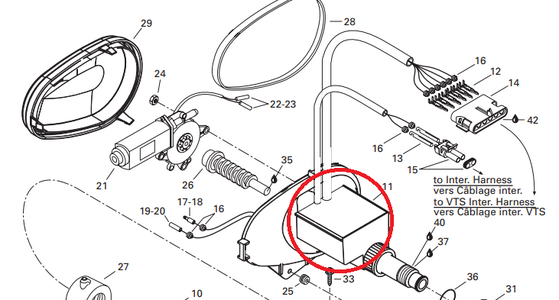

If I'm understanding correctly, it's not exactly the motor that would cause a problem. It's the "magnet" which tells the motor when to stop. Is that housed somewhere inside this part number 11? If I'm understanding correctly, then this means even if I replace the motor (#21), there's still the potential for a problem. I'm just trying to not fry the MPEM for a few extra MPH...so let me know if I'm understanding correctly.
