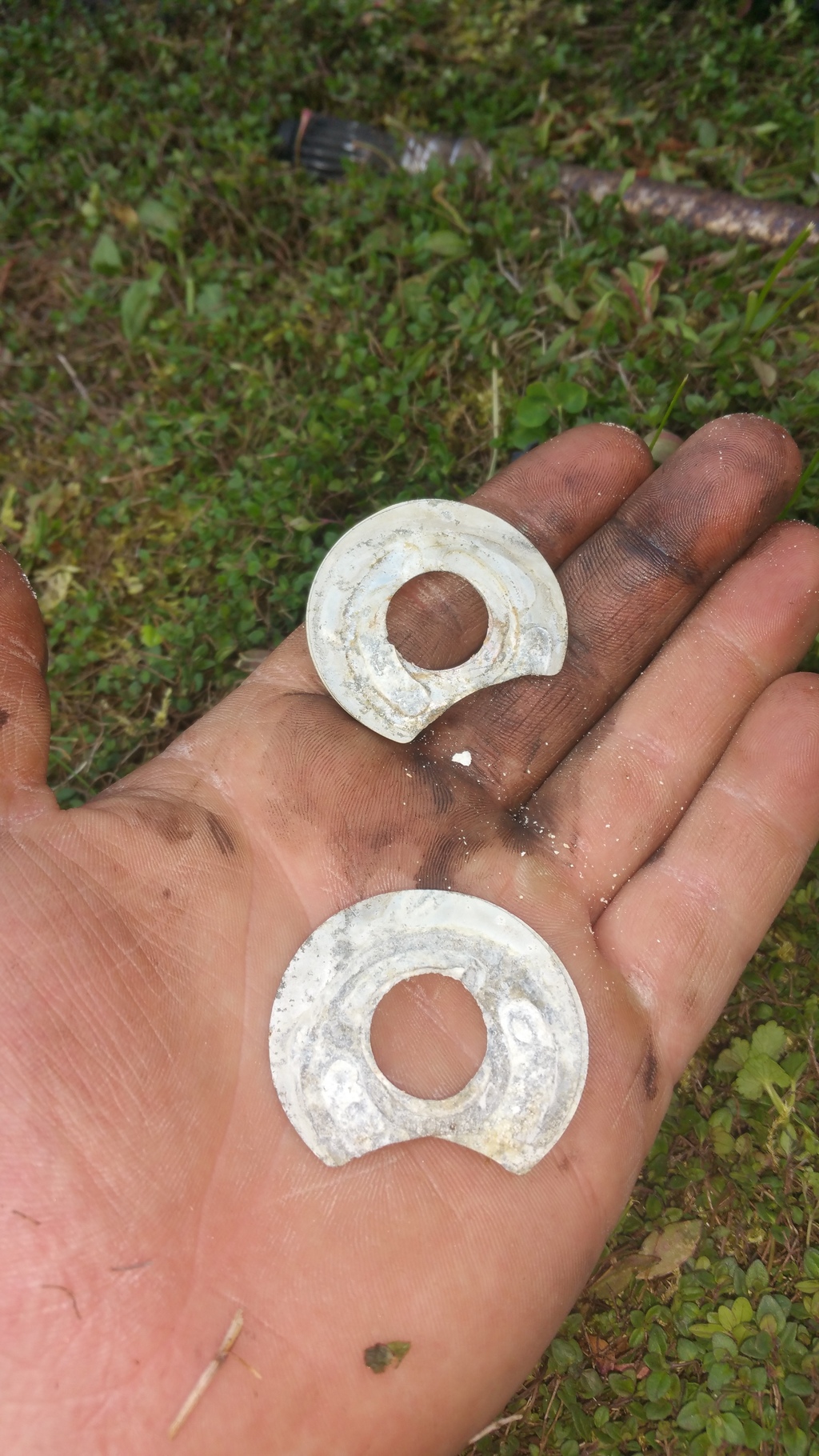

We also found these shims on both right side studs that hold the jet pump housing in place.. anyone ever seen these before? If so why were they only on 1 side?
Would i still need them even if im going to be re aligning the engine once my tool comes in? Also do you have any input on the impeller not having any play at all? Thanks!
I would think that they are there to align the pump with the hull VS the engine with the pump which would be done afterwards.
Or maybe they were the easy way to align the pump to the engine already bolted down ?
