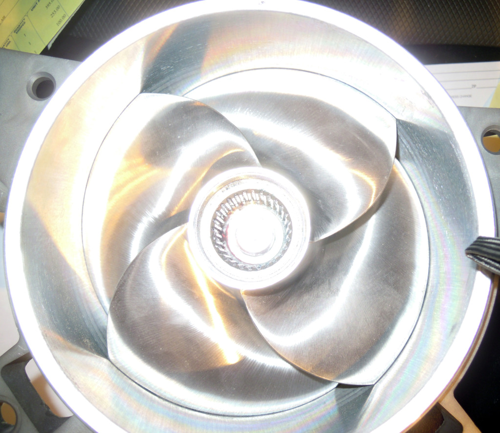

My 2012 RXP-X sucked up a small rock and it looks like this. It has 7 hours and look how bad the wear ring is.
I called Riva and they are not sure what after market impeller they are recommending yet. I have a Speed Control Overide Module but with the stock impeller I still made only 67MPH at 8150 Rpm. I told Riva I was going to get my impeeler fixed then at the 3 initial Place XXX. They recommended Skat Trak. I'm so glad they did. Glen the head of impellers and pumps guru told me why my wear ring looks so bad. He said, the pump design does not handle the torque of that 260HP spo well because of the design of only one big bearing.

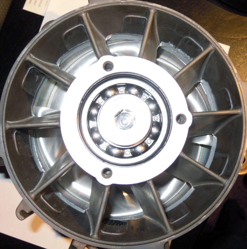

So he recommended this modification. I also had him install there SS wearing and set my impeller back, to try and get some more speed.
Can you even tell this is the same impeller repaired!!

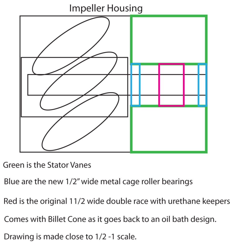

This is the bearing modification:

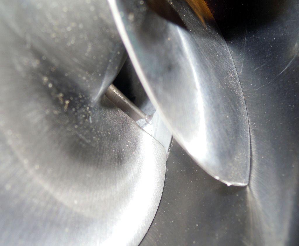

Look at the fit with the SS wear ring:

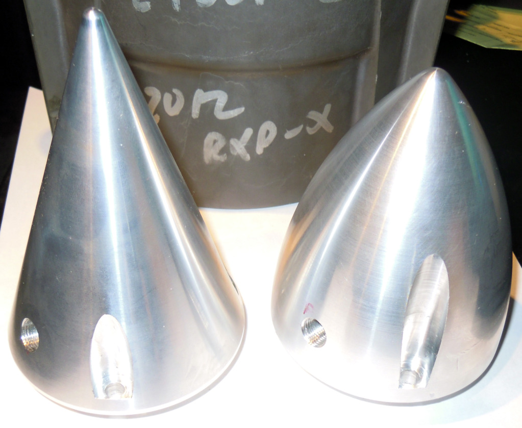

Billet Tail cone options:
I chose the long one.

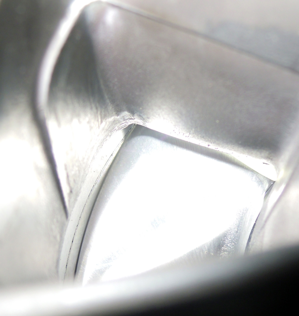

The set back impeller and the porting to make it match.
Thanks Glen you did an awesome job.
I'm riding it tomorrow and will let you know how it works.
Ed
