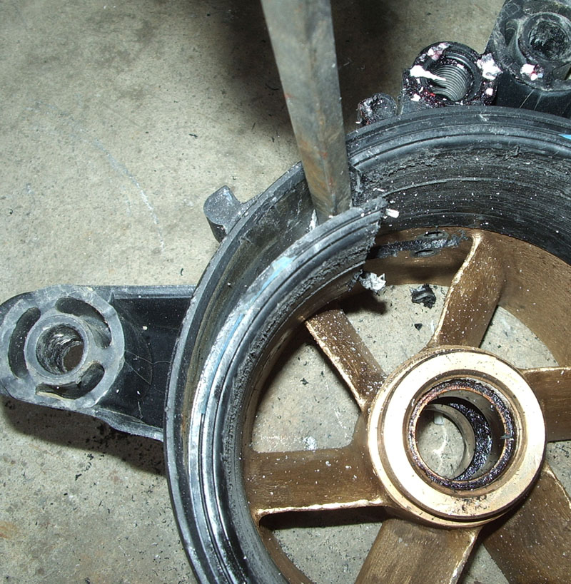

No problem thats what this place is for people helping people I was in your shoes two years ago I wish I had asked questions and joined sooner. Any who the picture below will show you what the wear ring looks like removed. The thing ahead is the impeller. obviously that wear ring is shot, if you see all the wear it has, no pun intended, that would need to be replaced, that cost a pretty penny if you pay someone to do it. Also as stated if the wear ring is toast the impeller might be dinged up.
When you go to look at the boat check all the items suggested to check not just what I am putting out there. But when you are looking at the boat go to the back and look under boat by the engines you will see two grates, this is where the water enters and if you look into those grates you will see the wear ring and impellers. The link below is an example of someone here that has pictures of the impeller. Good luck and happy boat buying welcome to the forum.
