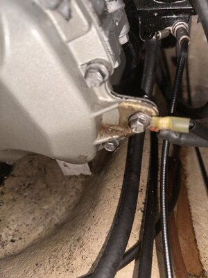

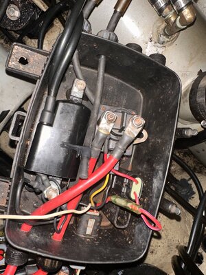

Check the grounds under the coil mounting bolt in the rear box

Thank you @tobytd - are you referring to the ground in rear electrical box or the wires grounded wherew 6pin cable is connected below pictures for your review
IMG_8738.jpegIMG_8739.jpegtha

This coil has been replaced, the old spark plug leads are just laying there. When was this done? Why was the coil replaced?
Since we were not getting any spark starter,stator coil was replaced by the original seller. Based on the troubleshooting we thought may be ignition coil is bad so bought newone from amazon and when i crank i get very weak spark.. trying to figure out what can be wrong
